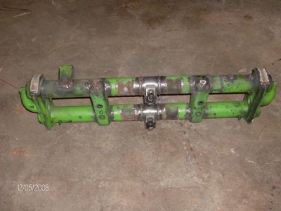

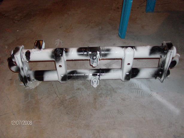

With rick's help the beam is ready for paint, 6" narrowed, no shocks, and adjusters,  this is more work than i thought.

It's not that bad.  I thought the hardest part was cutting the uprights off.  The rest was pretty simple.  Mine is complete except for the steering box bracket.  I have to wait until I get my body back on (which will be about a year from now) so that I know where to re-weld it.  Looks good.

I have shortned the tie rods, i still need to put the spring plates in, then i need to pull my beam to finish putting the arms and the link pins and the drop spindles.

I have not yet shortened the tie rods or spring plates.  Seeing as I have to have the body back on mine to fully finish my beam, I am in no hurry.
haha I know that beam,it came out of my 62 when Rick had it!  Originaly in my old 64 I gave Rick. :lol:

« Reply #8 on: December 15, 2008, 10:38:46 AM »
Sounds like it has been passed around alot, the green is gone, will update with painted picture.

« Reply #9 on: December 15, 2008, 03:33:06 PM »
Naw it was in the 64 Rick cut it down and ran in in the 64 until it died then the 62 till he tarded it to  me.

« Reply #10 on: December 15, 2008, 03:34:17 PM »
Oh...cut off them bump stops on the beam before ya beat yourself to death in that 62.

« Reply #11 on: December 15, 2008, 05:33:42 PM »
I will consider that, i painted it "cow" inspired,  i am going to have to pull the old one out soon and build the rest.

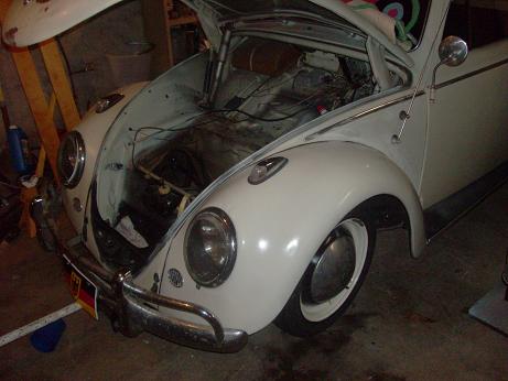

Finally got the beam together, balanced the 145-65-15's, and put the beam in the car lower the car down and bent my tag.  Still have to finish the job and adjust everthing.
