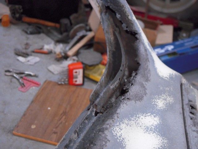

This is how it's looked lately:
Been put on the back burner but this past weekend I did start on some body work
Got some practice using the metal shrinker/stretcher, brake and Beverly shear
I know it could be better, but it's my first try at something like it and my dad was teaching me as I went
Also realized that the over-rider support holes were pretty torn up, so instead of trying to fix them I shaved them, I am using euro bumpers anyway
Started stripping the undercoating from the fenderwells. While I'm glad someone put it there (kept the car from getting much rot underneath) it's a major PITA getting off
And finally I started stripping the rest of the exterior as well. I did the roof with a DA and it took forever, I started using a stripper and it seemed to work but I haven't done much yet with it.
