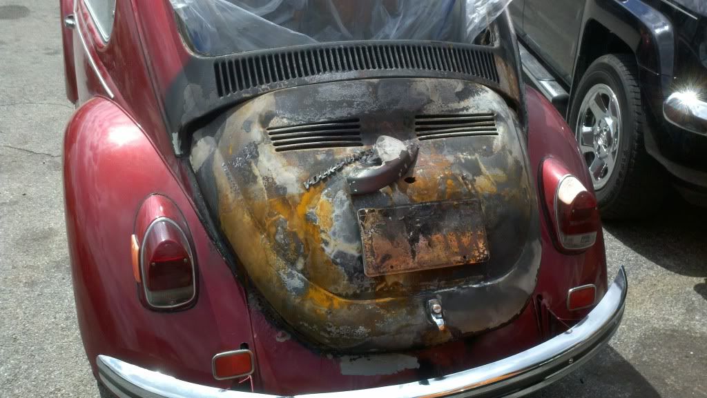

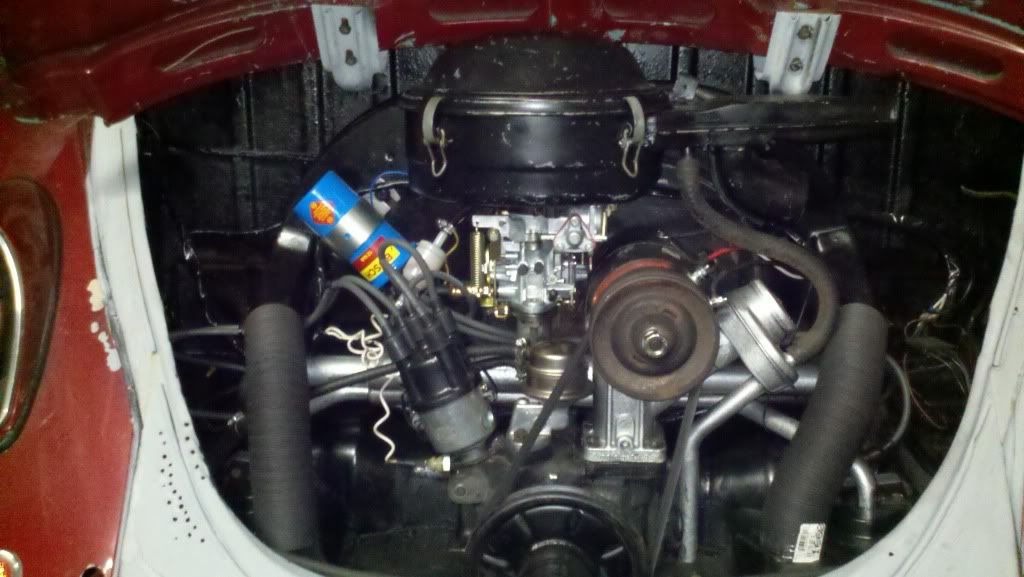

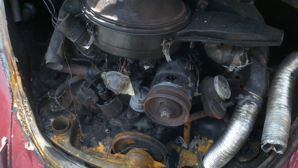

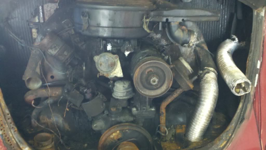

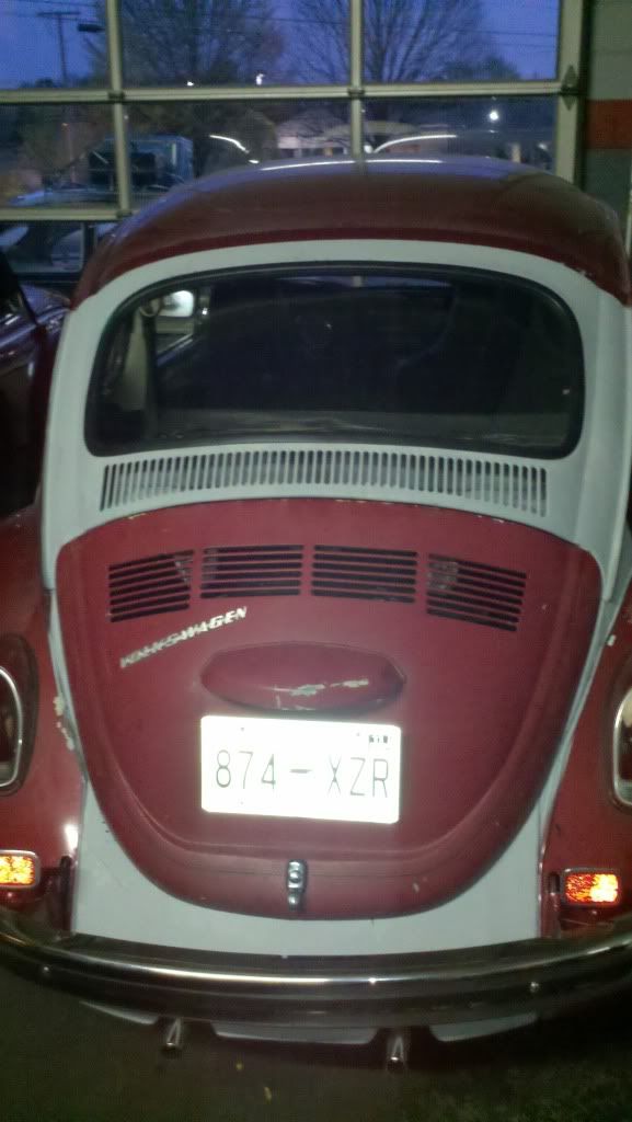

Well, here is Lenny's 1970 bug that burned a little while back, was the one that Travis was talking about in another post.  The fuel inlet nipple pulled out of the carb when the bug was running, then just fed the fire.  The fire dept. showed up in time to put it out before the block lit off and we were able to get it back on the road.  Lots of stuff melted and generally just made a mess...took longer to clean everything up than anything else.  The firemen also smashed the rear window and bent the deck lid beyond re-use.  Now he just needs a body shop to repair some body damage and paint it up.

Wow! Thats a job well done! That just goes to show that the little piece of wire holding the nipple in is very important!
Thats pretty impressive considering it was only a few weeks ago that Travis saw it on the flatbed. Glad you were able to keep another one on the road!
