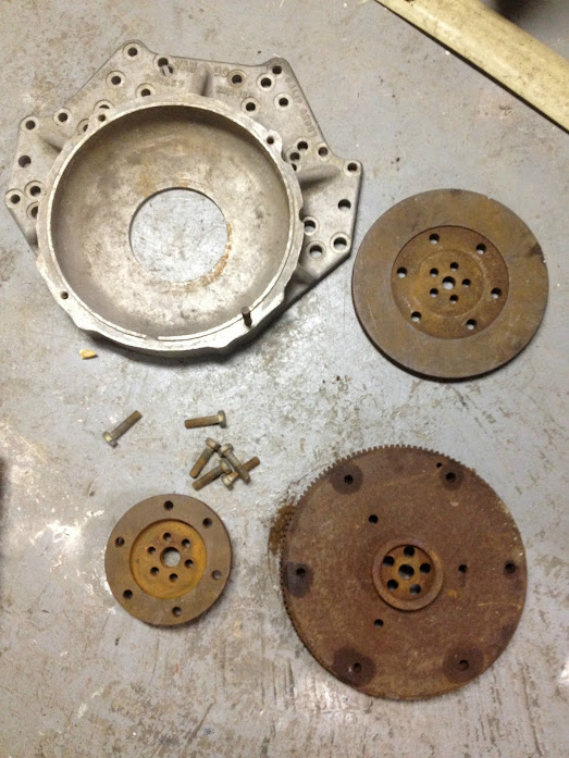

I have decided to do a water cooled conversion on this bad boy. I was given a GM 60 degree 2.8L V6 and I just got the hookup on a Hadley Vango engine adapter plate. The guy claims it will fit Chevys and fords- I4s to V8s! Things are falling into place  8)  :greenbay: :redbay: :whitebay:

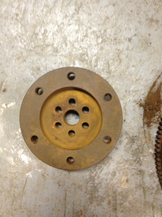

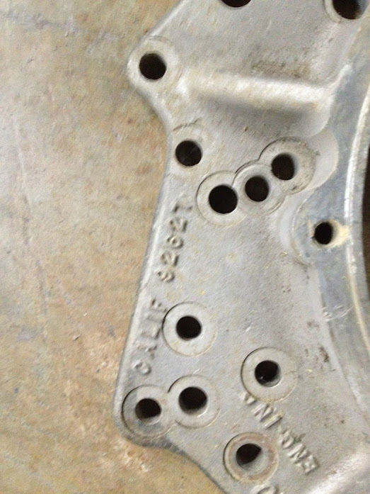

Here is the adapter plate and accessories. The plate is supposed to fit most 4, 6 and 8 cylinder engines. Looks like the second to last picture is an adapter to bolt to the crank. I don't think my 2.8l V6 has that tight of a bolt pattern. Might have to improvise.
This uses the stock type IV flywheel, clutch and pressure plate. The disc in the top right of the first picture shows a plate with a needle bearing in it (needs to be replaced). The flywheel bolts to it. It bolts to the smaller diameter disc, which bolts to the new engine. Pretty cool, huh?
