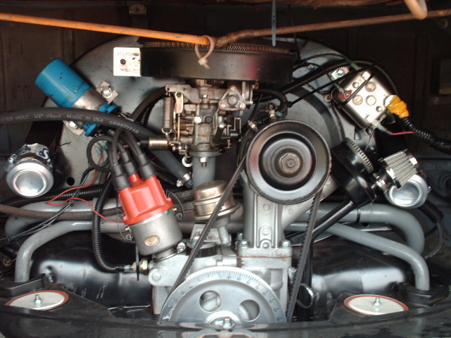

A type 1 conversion sounds like it would be cheaper, but ask Zen how many engines he's put in Homer so far. I think he's up to 4 or 5. If you want a type 1 powered bus, I think it would be better to get one that was originally type 1 powered, like that '71. It'll be way more original than a bastardized '74, and therefore worth more if it's left stock. Are there any photos of it? If you can get it at any type of reasonable price, it's definitely going to hold its value.
If you're more interested in the utility and less in the originality, a later model Westy is going to be a better choice. The camper configuration is more ideal, and you get a nice bed up top rather than a cot.
There's no reason to hunt down the Euro tin when you can get the fiberglass kit from Creative Car Craft. This is what Justin did on his camper and it's a great option. If you didn't know it was converted, you'd think it was a stock engine it looked so good.

Well that's convenient if you have the skill and time to build engines every few years. I have neither, so I'd rather put a little money into an engine that will last me a really long time to begin with. Otherwise, paying someone to rebuild my engines all the time would add up quick!
Get the Creative Car Craft tin if you build the '74. This is the only photo of Justin's engine I could find.
