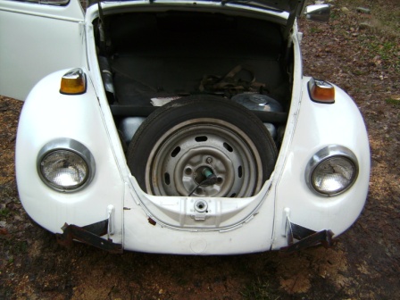

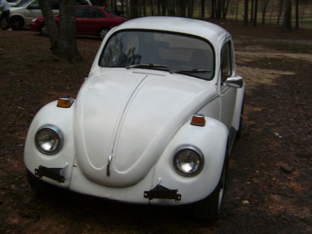

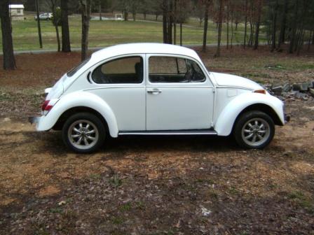

Here are a few photos of the 1972 AStick I got back in December.  Looks like its all original, 86K on ODO. I have new bumpers for it, just gotta get some bumper bolts and clean up the original mounts.
More later...
I added the Empi 8 spokes
Has original cardboard liner and gas tank...
Gotta get a new windscreen and seal...

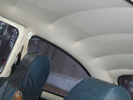

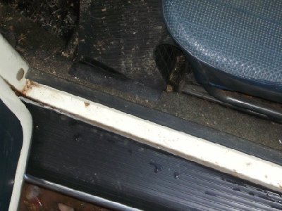

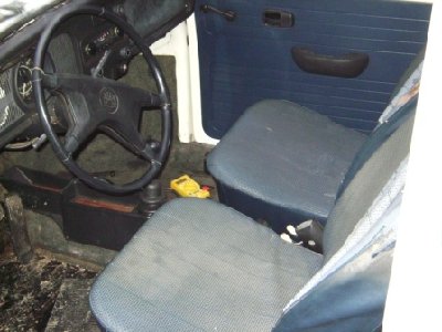

more...
good headliner
2nd layer of seat covers sun baked
Both heater channels and floor pans are good

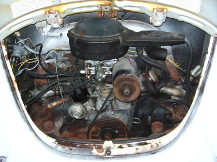

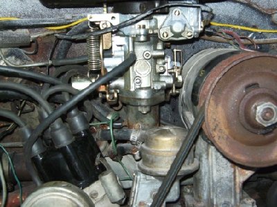

more...1600DP
New Carb

« Reply #3 on: March 06, 2008, 08:29:02 AM »
I'm looking at your vacumn hoses.  Your carb is not for a auto-stick,but not to fear.  The vacumn line on the backside of the dist is for vacumn retard. (early emission control) Block that one off . You can leave the port open on the vac.unit. Take the vac.hose from the "shift solinoid and plug it on the front of the carb. This may help smooth out some shifting. The vac.hose from the front of the vac. unit to the side of the carb is correct.  Re-check your timing. I'm sure it moved.
    Be sure to block off the port on the intake manifold. If all this doesn't help anything, put it back like it was and blame it on the non-auto-stick carb. :lol:

I apreciate it,
I'll do the plumbing changes tommorow or Saterday.

Re-plumbed the vaccume lines as per instructions and I can say that it does shift much better and not so hard.  Didn't have time to re-time, (hey it was snowing and 38 deg....) any way I am soooo excited about getting the ASBug running again...

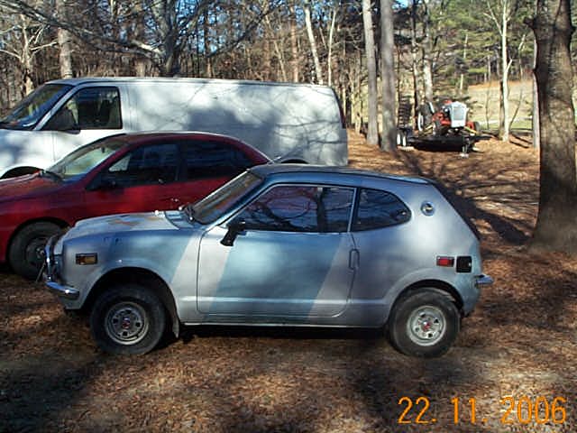

Went ahead and pulled the engine to fix the leaky push rod tubes, and to put in two new exhaust studs... Those buggers (or is it Boogers?) wouldn't move.... (Yes bugtech, I know you said so!)  Ever seen anyone weld on nuts with a mig on a Magnesium block - I hadn't, but my friend did a good job.
The car is currently getting new seals put all over the engine, new push rod tubes, new brakes, and a GREAT NEW German muffler put on!! The mufler is marked JL with some kind of square symbol in between the JL.
Still had all the plugs in the ports.....going to try and get it back before the BAPX show!
I've been driving the '72 Honda Z for a few days and I am hankering for the ASBug to be free to roll.
Any one know a Honda Nut?  My Z is one of only 14,000 ever made and is quite rare.  I am looking to sell so as to buy a '67 bug I have found.
Take Care,
