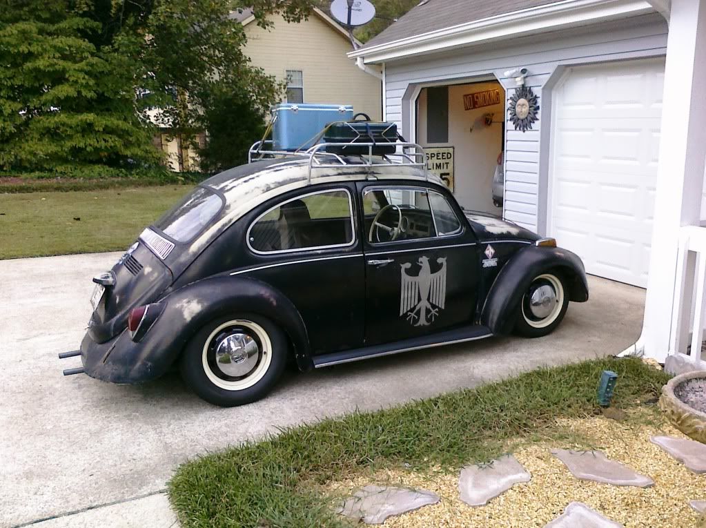

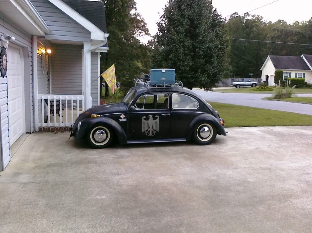

Here are some updated shots.  I made a roof rack and even found a 1970 Tn. plate for it.

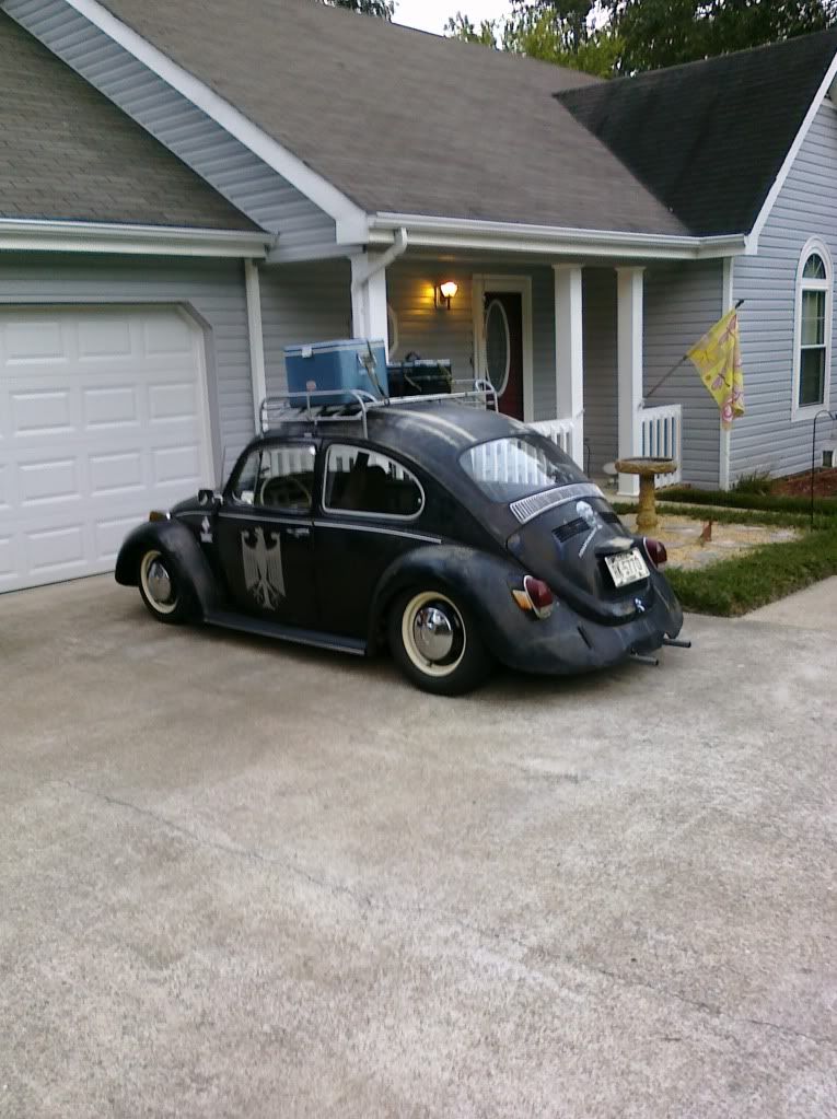

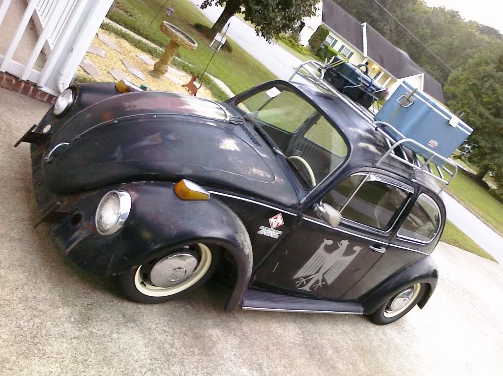

Here's whats been up...had a rotted framehead so off it came and up it went.  2in. framehead raise,1 in back and added 8 degrees caster.  Had to add a U joint to the steering column and raise the gas tank 3in. in front and 1.5in rear, this kinda leveled it out but I was still able to use the filler neck without modding it.  Now I have a low car NOT just a low BJ beam! 8)
