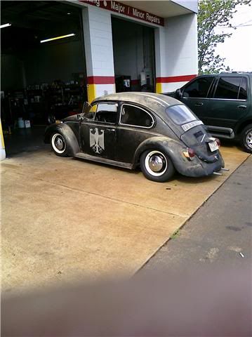

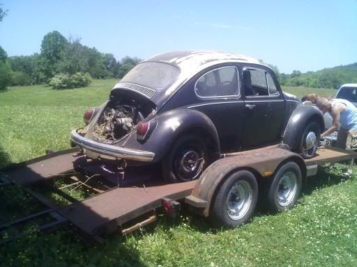

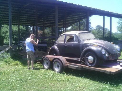

Here is the latest addition.  It's a 1970 barn find..and by barn I mean 4 posts and a roof.  It has been sitting since 98 and needs a few things done.  I have pans,carpet,running boards,a windshield,drop spindles,tires and a ton of work on order. I will up date as work gets done 8)
The deck lid has been off for years! :P

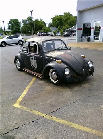

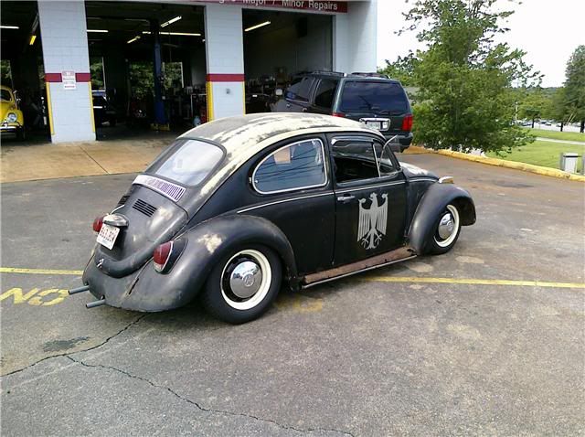

Some more not really cleaned up but getting there...as clean as it's gonna be probably ;D
down a few splines in the rear and new tires 165's in the rear and 135's up front.
started working on the brakes...freed up all the wheel cylinders, replaced a few brake lines and master cylinder.

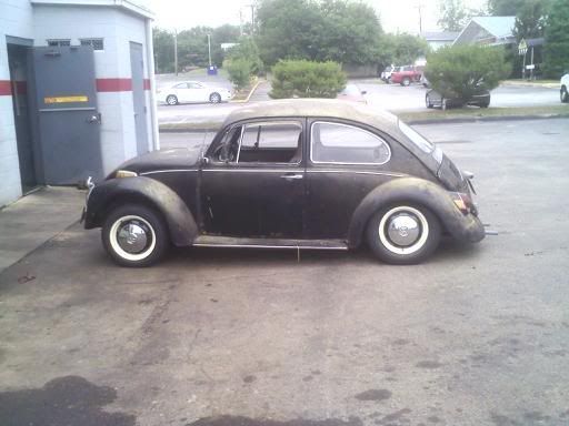

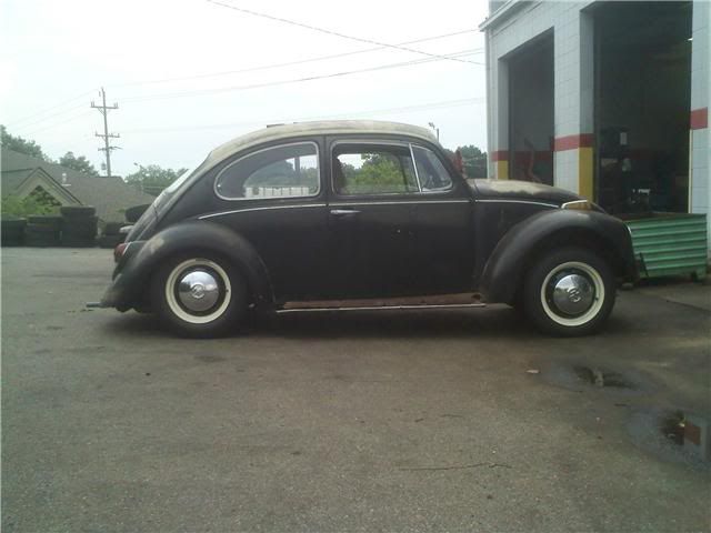

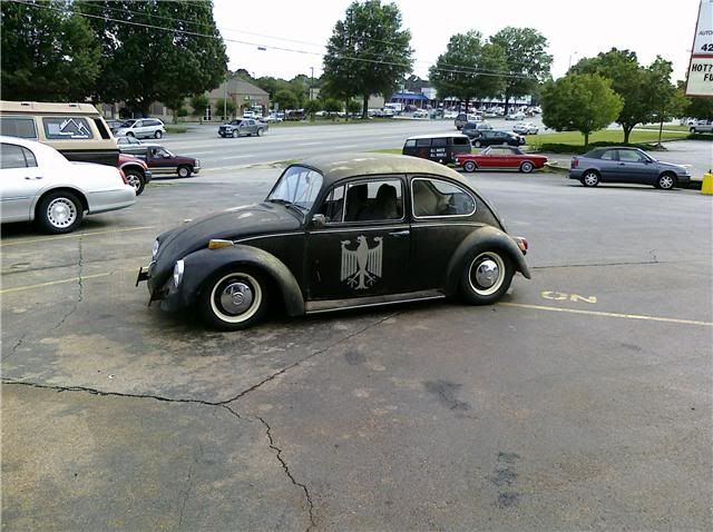

Some more..Freed up the engine, cleaned the carb and got it running, pulled the engine and replaced the release bearing..someone already replaced the clutch before it was parked and that seems ok, just the bearing was trash, narrowed the beam 6 inches, rotated the torsion mounts, and installed the drop spindles up front..gettin close to hitting the road with it...need enough floor to keep the battery off the road first though ;D

What were those things in the front fenders in the 1st photo?
Horns?
Just curious.
Re: 1970 hoodride
« Reply #6 on: June 14, 2010, 09:46:32 AM »
Horns?
Just curious.
They look like Uni-vents.
Aftermarket vent tube systems that brought a nice breeze into the car.  popular back in the day.  I have a set in the box still, waiting to go on something.   8)
