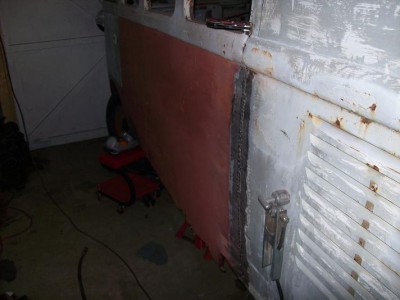

« Reply #68 on: May 15, 2009, 07:51:21 AM »
Last night's progress....making progress, finally getting into the welding of the driver's side.  The door opens and shuts now just like a real car. I loved the Dukes of Hazzard as a kid, but the thought of attempting to guide my big arse in and out of the sliding window was too much for me to comprehend...

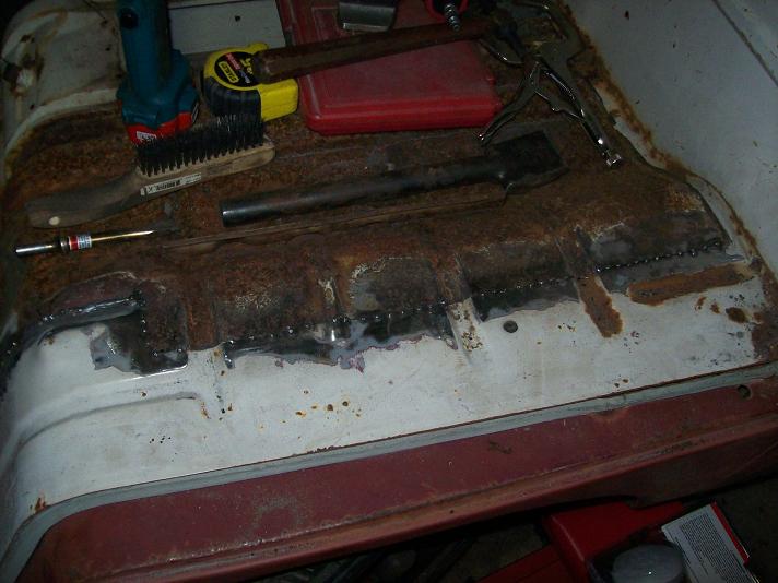

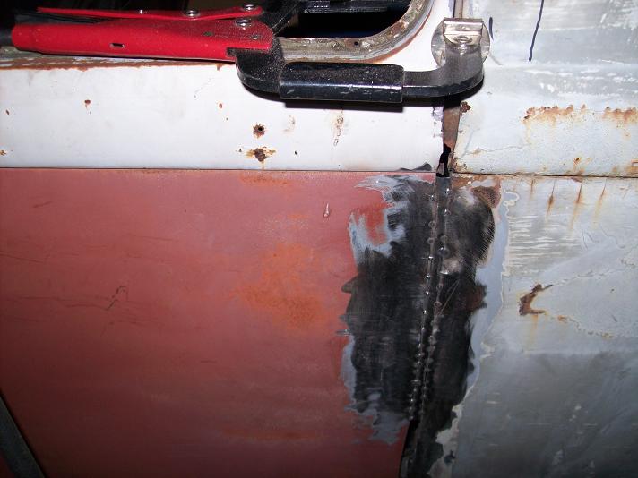

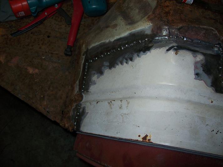

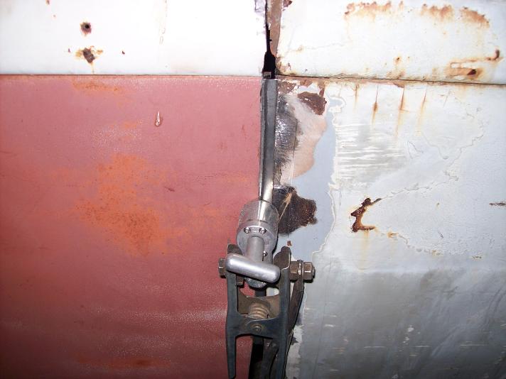

« Reply #69 on: May 15, 2009, 07:55:22 AM »
More pics, from grafting in the rear quarter section.  just tacking everything, getting it all in place, then later will come the pretty welds...
using sections of metal that i  created a flange on to overlap behind the panel and fill the gap
starting to join the two sections
final fit of the rear lower section
