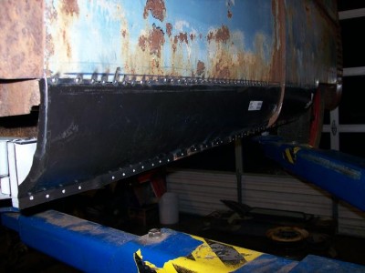

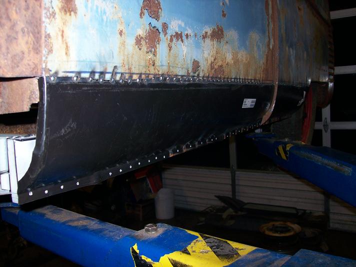

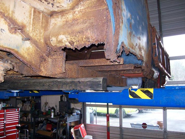

I decided to pull another marathon job on this heap.  From roughly 5p.m. till 10:30 last night, and from about 9 this morning until a little after 11 p.m. tonight.  Tired now, but got a lot done.  Got my axle beam finished, and installed.  Cut out the front crosmember, and remaining outriggers, floor supports, welded in all new metal, got both inner rockers in, and was in the process of installing the outer rocker on the driver's side when the wire ran out in my welder.  I'lll finish that up in the morning, but the good news is that it's sitting back on the ground, now at a more respectable height.   8)
And, of course that the holes are diminishing.....

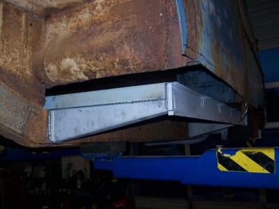

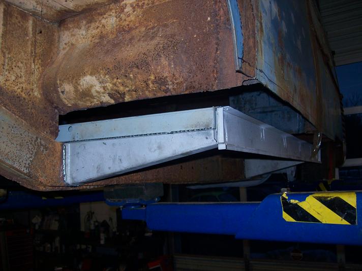

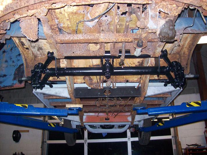

« Reply #93 on: January 24, 2010, 01:27:14 AM »
Underside pic.... New crossmembers, Front and rear, three floor support channels, new outriggers... 2" narrowed, adjustable beam with 3.5" dropped spindles.

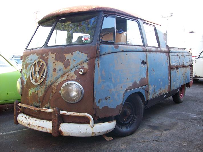

« Reply #100 on: January 25, 2010, 01:46:14 PM »
I need to get the right wheels and tires on it, but you get the idea....
