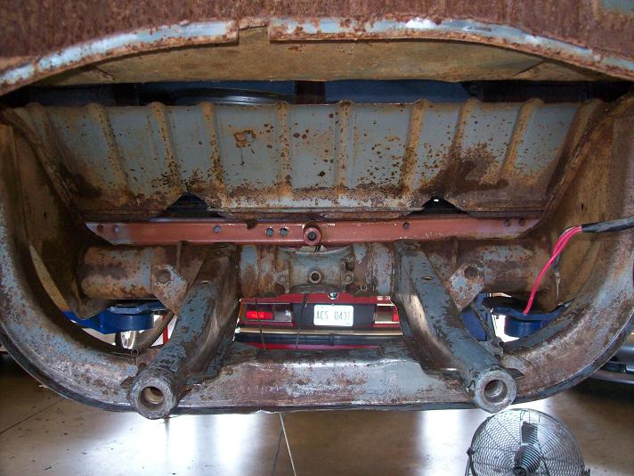

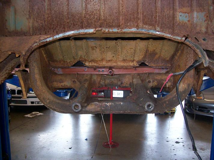

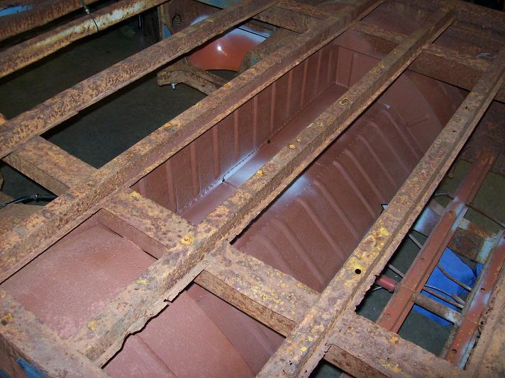

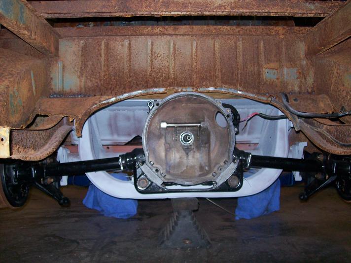

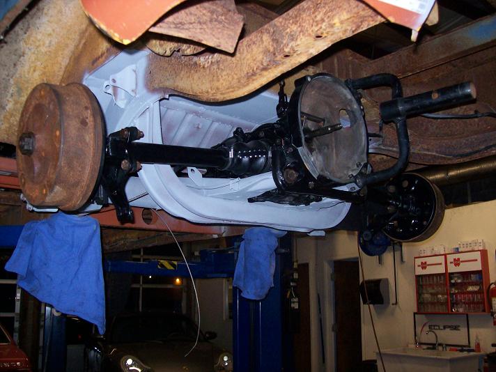

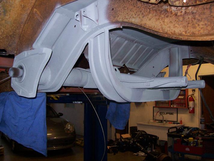

Another solid weekend day of work.  Spent all day Saturday, got the remainder of bad metal cut out from the rear bulkhead area over the trans, installed a section of metal that i fabbed up for it, cleaned up the rusty areas of the inner rear wheel wells, primed them with rust inhibiting primer, then removed 50 years of grime and muck from the trans. carrier area and primed that.  Last, got the refreshed type 1 rear transaxle back in, ready to set the wheels on the ground.....
A really good day.   8)
Pics....
1959 Double Cab
« Reply #76 on: November 22, 2009, 09:39:07 PM »
Trans. cradle area....
1959 Double Cab
« Reply #77 on: November 22, 2009, 09:41:35 PM »
Ready to sit back on the ground,

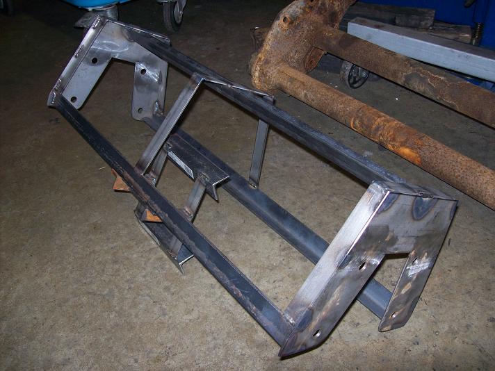

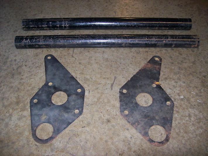

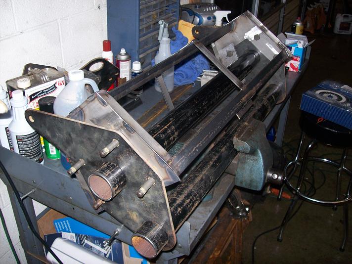

Finished up my alignment / frame jig for the custom beam i am going to build.
 8)
1959 Double Cab
« Reply #82 on: December 03, 2009, 08:19:12 PM »
Front end will be running 3.5" flipped spindles, 2" narrowed beam with adjusters (still retaining shocks).  Probably will raise the steering gearbox as well to avoid any impending collisions with our stellar roadways....  8)

« Reply #89 on: December 18, 2009, 04:35:38 PM »
Haven't forgotten this little jewel.  Starting to collect pieces for the beam.  Adjusters on the way from Cali, Money Order for the bushings will be sent out tomorrow, Spindles boxed up, waiting to head to Ohio to be modified, flipped.....   Just started to mock up the parts....  It'll be sitting on it's nose before you know it.   :thumbs-up:
