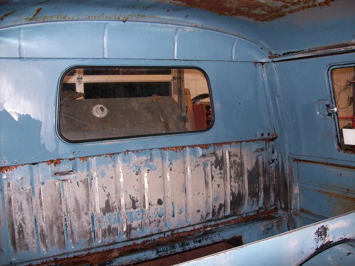

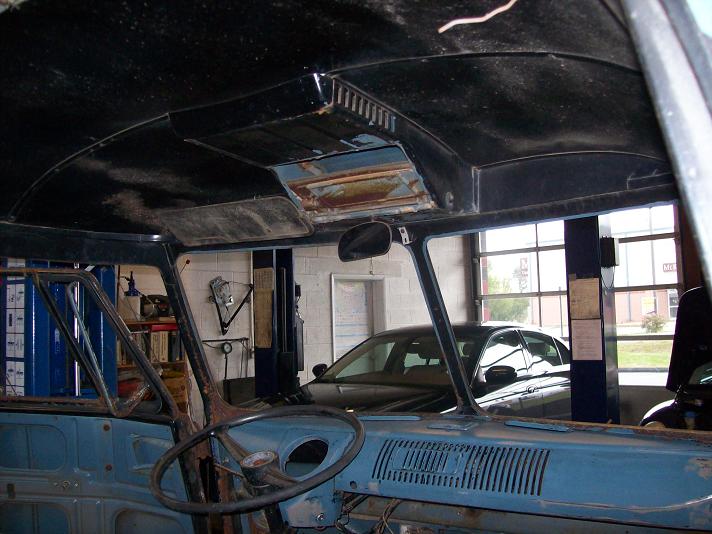

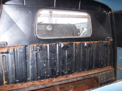

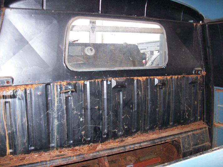

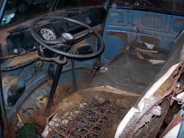

Changed directions slightly... stripping all of the aged all-over re-spray black paint from the interior while the run-off can still just drain out the bottom.... :wink:
Hope to get back to the welding after all of the black is gone.
Nothing quite as pretty as 50 year old og Dove Blue.   Thank you Oven Cleaner.  Going fairly quickly, all should be cleaned off by the end of the weekend.
As it was before

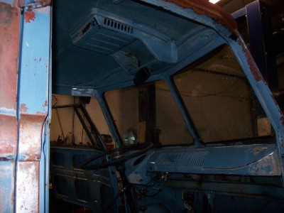

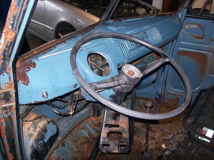

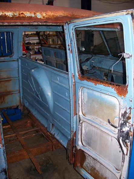

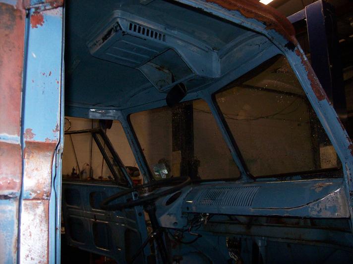

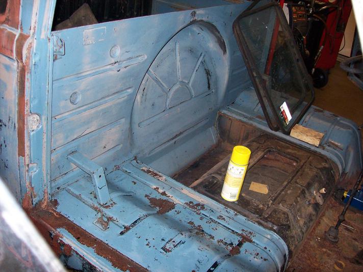

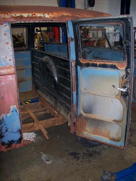

Went in to work today to finish up the removal of all the black paint in the interior.  Went well.  All that's left is some edges on the cab doors, that's about it.  Really was surprised how nice the original paint looks in this pile. (the original INTERIOR paint that is...)
As before, nothing but Easy Off and some soft scotch brite pads along with a lot of work was all that was required. 8)
Before / After pics:
1959 Double Cab
« Reply #49 on: October 18, 2009, 12:58:11 AM »
Rear Section....
1959 Double Cab
« Reply #50 on: October 18, 2009, 12:59:44 AM »
Cab overhead / Air Box....

yup. pretty tired this morning.  But, glad that i got it done.  I had a hell of a mess to clean up in the floor from it.  I didn't want Waymon to come in Monday morning to a black lake of funk staring him in the face.   :wink:
Headliner was in perfect shape, so i'll just re-paint it gray, and put it back in.  found the missing interior cab door handle under the front seat pedestal area.  The visor is in darned good shape, just need to clean it and put it back in too.  Very happy with how the day turned out. Now it's back to the nasty cut, grind, weld stuff.  At this rate, he'll be ready to roll just in time for the coldest part of winter.
