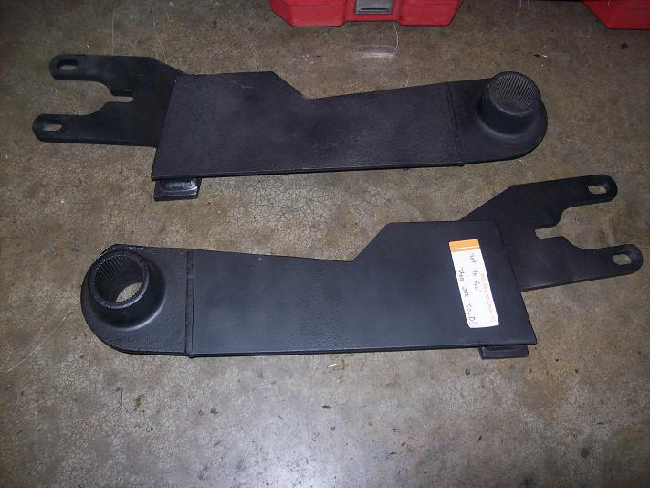

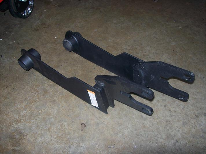

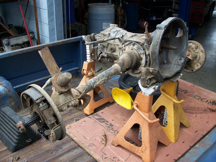

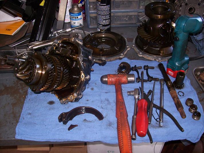

I've been doing a little work on the drivetrain during lunch, before/after work....
Donor transmission from a 68 Beetle for the straight axle conversion, Offset modified Spring Plates......

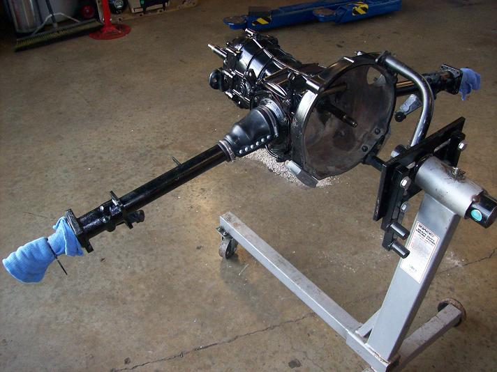

Tore down the transmission, looked pretty good, replaced the rusty input shaft, replaced a broken shift fork (common stuff)....  Reassembled, re-sealed, ready to go in..... 8)

mmmm.... offset spring plates.... 8)
1959 Double Cab
« Reply #26 on: October 12, 2009, 04:28:01 PM »
cooll, it is going to be the shiniest thing on the bus,  remeber, don't cut the trans away!
1959 Double Cab
« Reply #27 on: October 13, 2009, 08:13:51 AM »
Naw.... no cutting away the trans. on this one.  I'm just cutting up the rest of it.... :lol:

Are those plates guaranteed not to rip,stretch nor tear ?   I would almost be tempted to drill a couple of holes in each plate and install some really good bolts/nuts though those welded blocks to be safe :-k  I was wondering  how much torsional twisting the plate could stand before those welds gave way. They look strong but-----
1959 Double Cab
« Reply #29 on: October 13, 2009, 02:00:00 PM »
You are correctt sir... they have been well tested and tried by numerous others, and the fabricator is one of the most skilled welders i have met. I wouldn't try it, in other words, but i'll trust him.... :wink:
