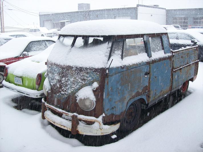

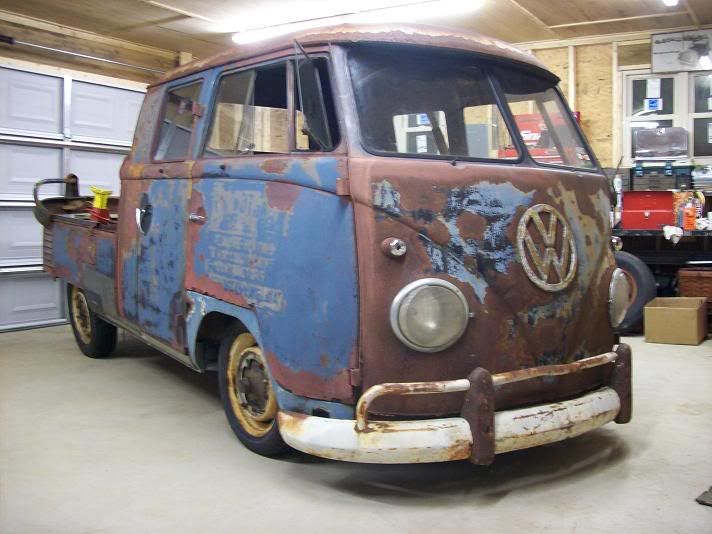

« Reply #106 on: February 04, 2010, 04:41:12 PM »

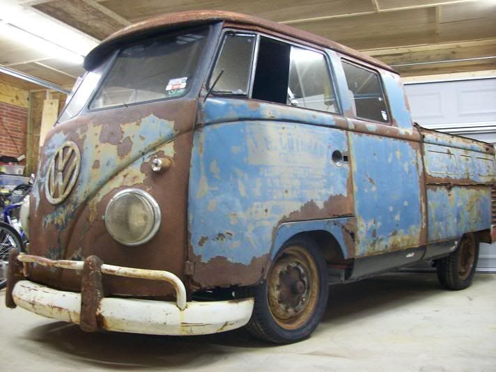

Took a quick pic as the snow was starting to fall last Friday.  From this angle, It looks about ready to go.
Man, I wish  it was running.   :cry:

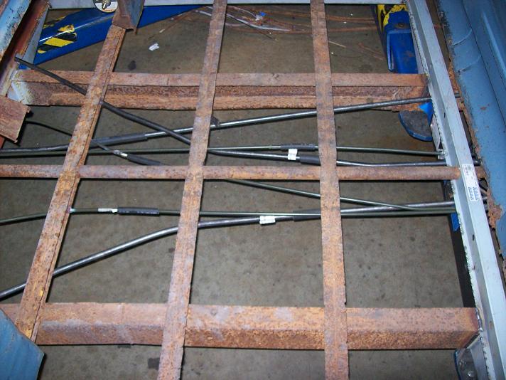

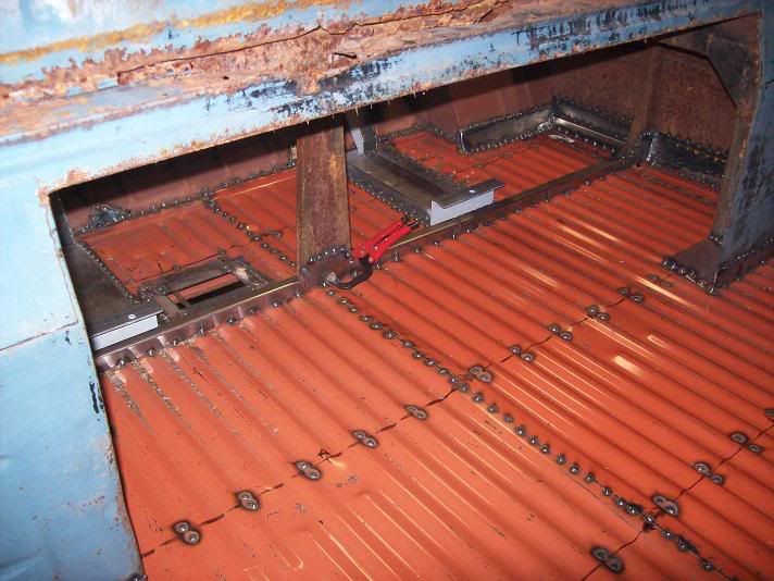

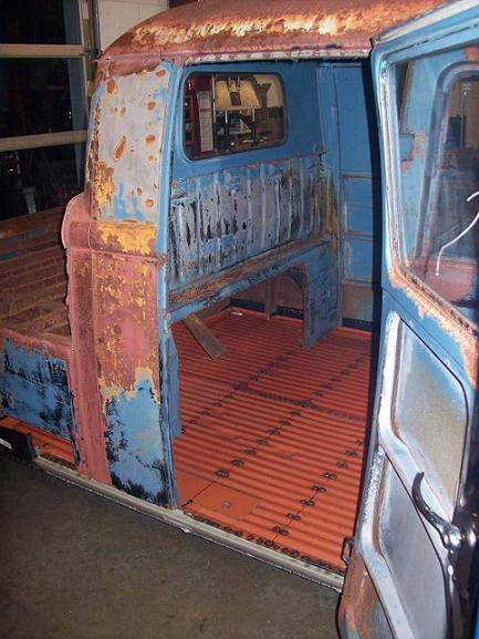

« Reply #113 on: February 21, 2010, 10:59:41 AM »

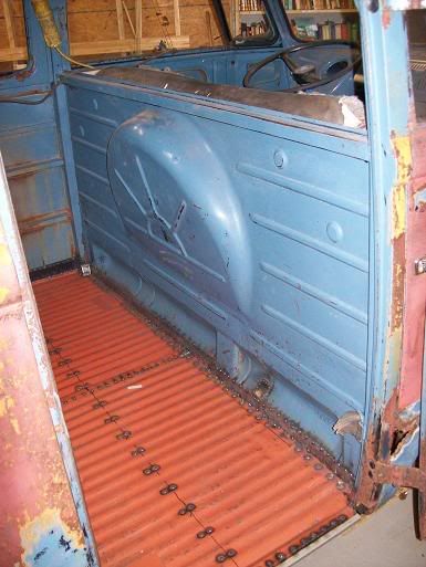

Another very busy Saturday spent on the heap.
Made up all new cable conduits for the underside (the old ones were rotted badly, imagine that... :roll: )
Finished welding the driver's rocker up, welded the passenger rocker up.
Floorpans modified, installed, got those mostly completed, welding bottle was getting really low, and I was getting really tired at that point, hope to get it home to the garage this next week, so I might still get it done in time for a bit of Spring time fun.   :D
This thing hasn't had this much steel attatched to it in decades.   :lol:

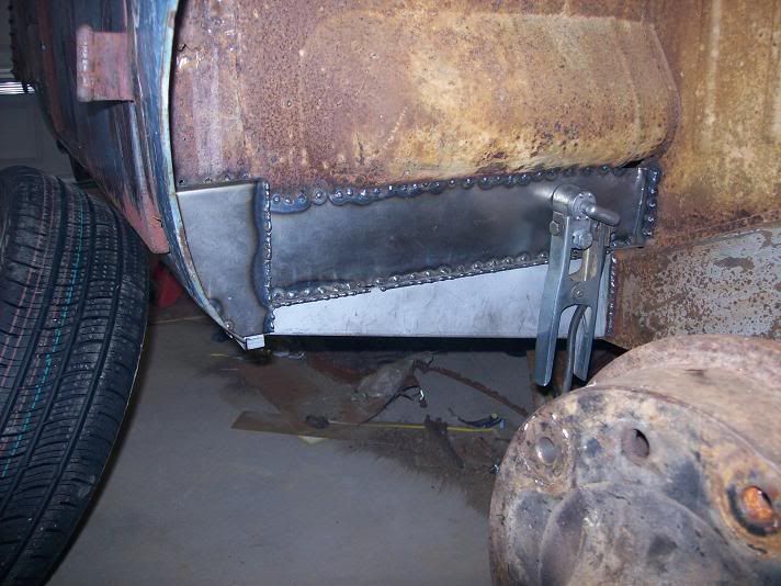

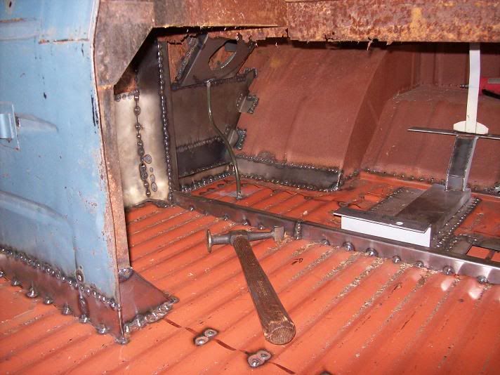

« Reply #114 on: March 10, 2010, 04:27:16 PM »
Finished welding up the rear floor section, fabricated new fuel tank supports (installing a larger bay fuel tank), fabbed up the filler neck, almost done with the damage repair to the right rocker / quarter area....

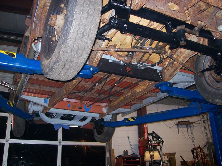

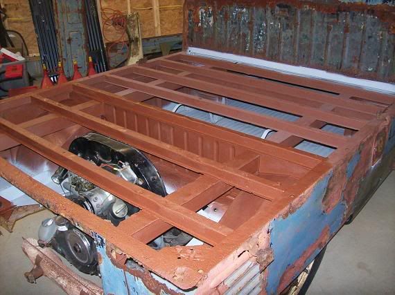

Re: 1959 Double Cab
« Reply #116 on: March 15, 2010, 08:58:20 AM »
Tank divider wall framework... done.
--Rear Corners to the fuel compartment closed in.
--All lower support sections repaired. panel supports made, welded in....
--Rocker / passenger side welding done....
--Left front inner fender well done....
--Tires mounted, had to pick the rear up spring plates a spline so i could actually get the tires and wheels on the truck.  The right front tire leaks down after about 8 hours.... stoopid rusty rims.... Got a little rake going on, but that should disappear as soon as the engine is in and the new metal welded in the bed...
 Pics....

Re: 1959 Double Cab

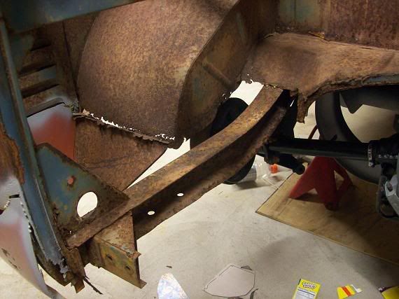

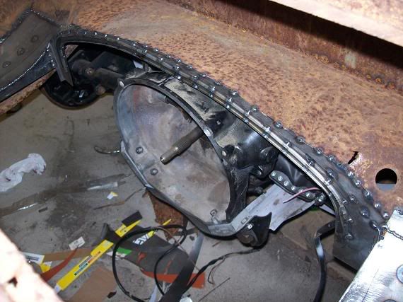

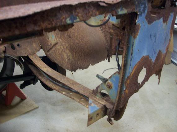

« Reply #119 on: March 22, 2010, 11:39:13 AM »

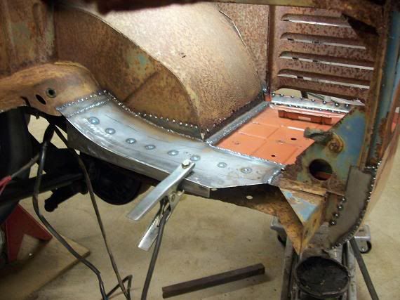

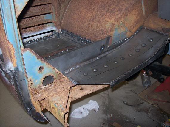

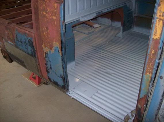

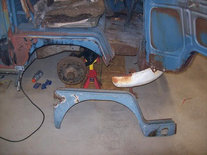

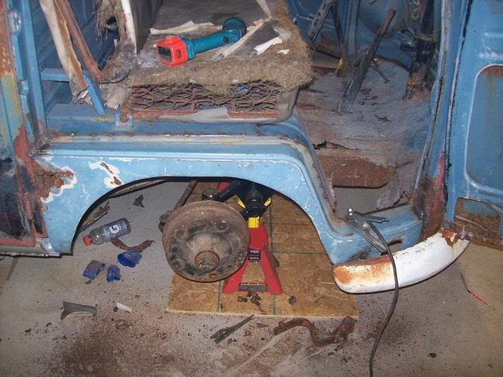

Fixed the inner wheel arch last week, along with the leading floor edge in the passenger area...
More work over the weekend...
Cut out rusty remnants in the engine bay, fabricated new sections, welded them up, fixed the rear corners (the welding work, still need to fill), covered the rusty interior area surfaces with rust primer, grey primer on the rest, will seal it up tonight, then paint with rustoleum gloss grey tomorrow.  Coming along nicely.   8)
In my tradition... more pics...
