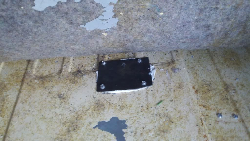

Sorry to get back so late....I DID cut a whole out to make it easy to reach my sender...I thought I needed a gauge the needle works when I connect the power side...I believe I may need to rewire from the sender to to the gauge....
