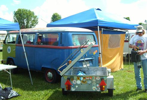

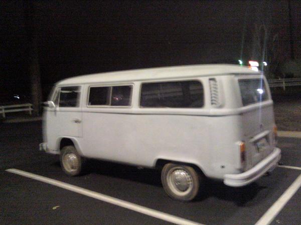

Looks pretty darn good now!  Keep in mind that's coming from someone who drive this:

Zen,
Do you actually have a tent for Homer?
(I like Homer, it was my Gpa's name...)
Any way King, don't let Zen fool ya, that is an old photo, Homer looks even "better" now...
Good luck with the bus, wasn't trying to be a downer, but just wanted to bring up that the bus isn't the cheapest VW to maintain.
Windshield and/or seals for a 1978 Type 2 Bus
« Reply #9 on: December 21, 2009, 05:54:06 PM »
No I don't have tent . . .that was Kyle's.  Kyle's Vanagonagon was under the weather so we loaded up Homer and went to FunFest at Mid-America Motorworks.  The cool trailer belongs to a former club member who moved out west somewhere and left it with Kyle for safe keeping.  We didn't want the wheel bearing to rust up on it so we loaded a bunch of stuff in it  before we headed to Effingham, IL where that pictrure was made.  I bought a Shopsmith while I was up there.  It was an interesting trip.  Yep, looking at the picture, Homer's paint has faded quite a bit and the roof is much rustyer now.  But it's still going!
