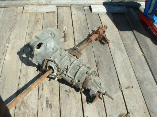

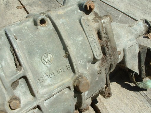

Look what I found in my shed this morning, Hm.
Need a swing axle transmission
« Reply #3 on: October 18, 2005, 09:11:14 AM »
Ah !  A  "Dinasours Wrecktus"  Boone ,If you don't know if it is any good, you might ought to put it back in the shed.  These little "boxes" were tough as nails as long as you remembered you had to stop to go to first gear or mastered the art of double clutching. Drivers would shed teeth off the mainshaft in the process. I suspect that your tranny is a middle to late`50s with that 102B number. We use to replace the mainshaft with the new and improved  "B" style. That shaft was one piece from the front of the main case to the clutch. About 2ft long.  Enough aleady  :lol:
