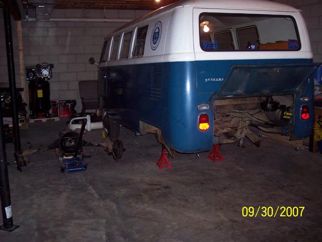

Sunday we got up and enjoyed the crisp fall morning.  Eventually we started packing up and was getting ready to have our cookout at the pavillion.  So we all pulled out of our campsites and start heading toward the lake.  I shifted into 1st and then 2nd, everything felt good.  Then I shifted into 3rd.  As I started to let the clutch out I heard that dreaded sound that makes you cringe everytime it happens.  :shock:  So I depressed the clutch again just in case I didn't shift it into third well.  I jigggled the shifter and shoved it back up into 3rd again.  Once again that horrifing sound!  :-s
So I tried 4th and it was fine.  So after the picnic we headed home without 3rd gear.  As we traveled home and had to stop and go I noticed it was getting harder and harder to get it shifted into 4th without too much grinding.  Well we made it home!  [-o<
I called Godfather for a few pointers and what the best route would be to fix the problem.  With his advise and knowing I don't want my bus on down time for long, I headed straight to the basement and started wrenching.  3 hours later: engines out, Transaxles out.
And Thanks to Godfathers quick searching =D> , I will have a great replacement sooner than I thought!
