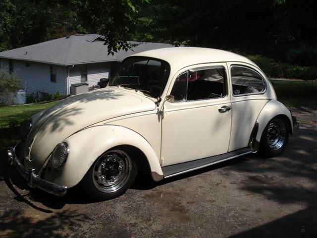

It would be easier to do it now. The picture I posted of mine is 2 outer clicks if thats too low then try 1 inner spline any less than that and whats the point? :lol:

Cant blame ya there,when in doubt weld some ore. Important thing is that it true and strong. As far as how low you can go the 67 pic is about as far as you can with out getting crazy.
