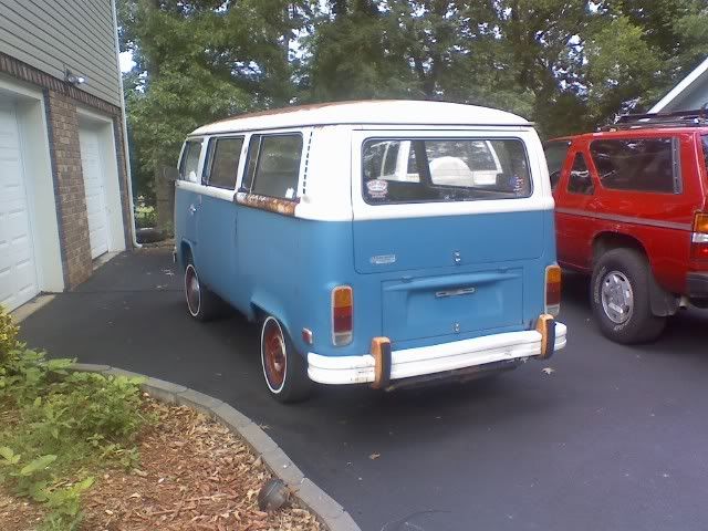

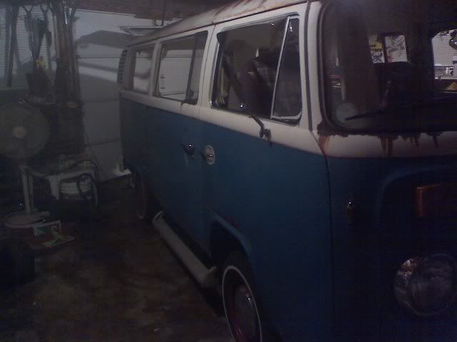

Here she is, on the day I bought her:

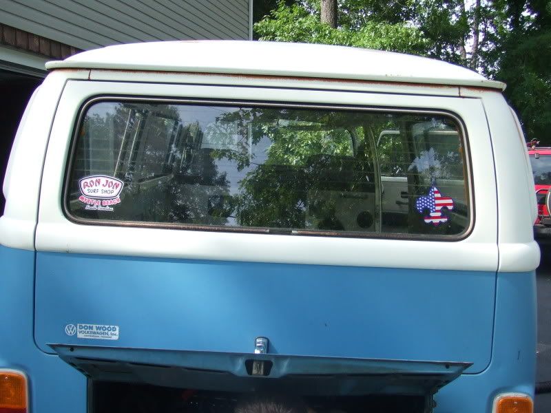

Dealer sticker from the back of the vehicle:

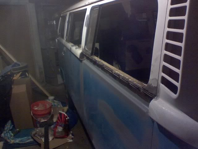

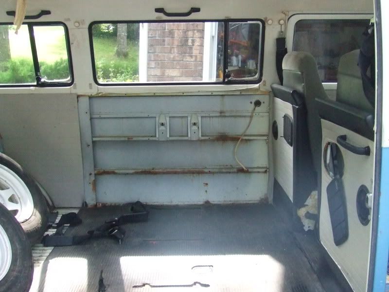

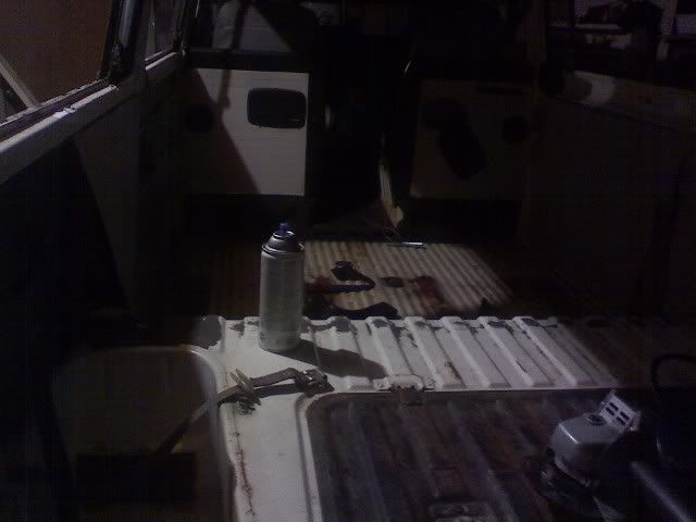

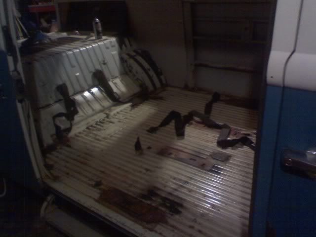

and also here are some pics from the beginning of the restoration up to where I am now...

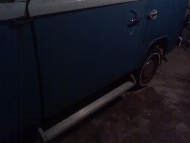

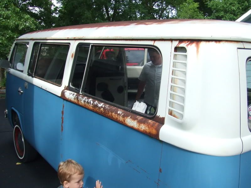

and a couple of the passenger side...notice the side step!

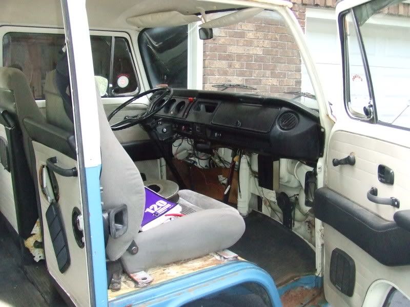

and finally a couple of the interior floorpan!

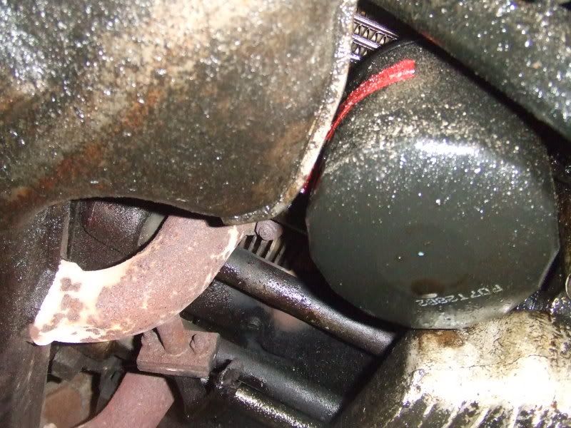

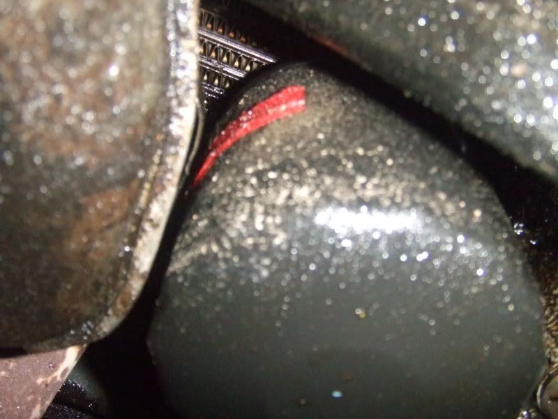

Did these bus's come with an oil filter?? I'm not used to seeing one on an air cooled vw but I noticed what looks like a black ol filter next to my oil pan underneath... I will try to take a pic and post it...

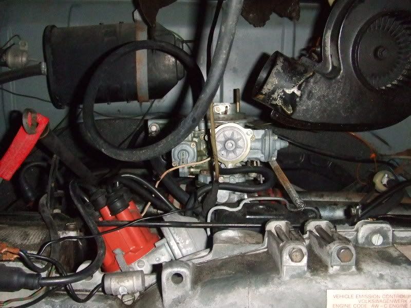

here is a pic of the 2 barrel progressive carb that is on it...not sure of brand but it looks new:
and here are a couple of pics of the oil filter I was talking about:
PICS* Just had to buy another vw... 1974 bus! Restore time!!
« Reply #8 on: June 02, 2008, 10:26:53 PM »
Yep, you have an oil filter. Best ones are the German Mann/Mahle filters, which you can get from Bus Depot: http://www.busdepot.com/details.jsp?partnumber=021115351A
I've actually got three on order now, if you need one let me know.

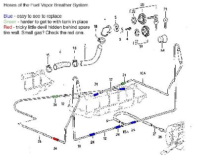

Does anyone with a bus know where the hose goes that splits off to the metal tubes that run up the sides of the bus to the vents along the top sides?
Got a picture? I'm having a hard time visualizing. Unless you're talking about the hoses that connect to the blower at the top of the engine compartment? I noticed at least one of those is missing on yours.
Like this?
Offline 74loaf
  • Hixson, TN
  • Joined: Jun 2008
  • Posts: 303
« Reply #11 on: June 02, 2008, 11:44:35 PM »

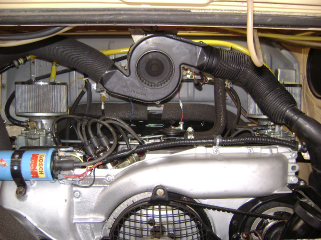

well, someone added a second blower directly to the other side of the motor...dont know why or how effective that would be...
the metal lines  am talking about can be seen from outside the bus if you look through the vents at the back sides... the end of the lines that I can see arent connected to anything in my engine compartment...

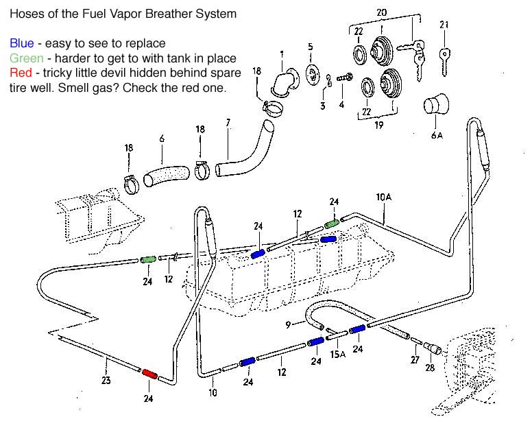

« Reply #12 on: June 02, 2008, 11:49:12 PM »
Oh, those sound like the vent lines for the fuel tank. Do you smell gas?
This is a diagram for a fuel injected system, but as far as I know it's similar.
Offline 74loaf
  • Hixson, TN
  • Joined: Jun 2008
  • Posts: 303
« Reply #13 on: June 02, 2008, 11:55:03 PM »
yup, thats them! where do they connect to after coming together in the engine compartment? I smell gas, but only because hose #9 isnt connected to anything
« Reply #14 on: June 03, 2008, 09:23:22 AM »
They should somehow connect to a charcoal canister. I think I see it mounted to the firewall in one of your photos above.
