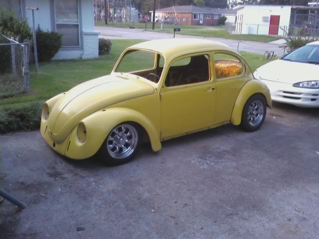

What is the advantage of a 6"?  I have been doing tons of research and most everyone goes with the 6".  Most of them say that you cannot use shocks if you narrow that much and that there may be some problems mounting the steering box.  I am really unsure of how much specifically I want to lower it at this time.  I do know that I want a rake to it and for it to sit as low it can but still be able to drive the damn thing.  I like the stance of this bug below.  Note: the engine is not installed in this car.  I had planned on running the same wheels as in the photo until my guy I was buying from backed out.  So for now it is back to stock wheels.

« Reply #4 on: November 03, 2008, 02:25:41 PM »
Oh btw that yella bug looks like 1 outer or maybe 1 inner spline in the rear and looks to be rockin 135 tires and guess what probably a 6inch beam.
That is what I call the cal look stance. It aint hammered but he did go all out with a big boy beam.
Smaller(185/65/15) tires would help the rear a lil.
This pic is as low as you can roll a ball joint car and not hit stuff.
2 splines in the rear, 4 inch beam (narrow 4 inch tire 135's)Rear tires 185/65/15. If it had anything other than stock rims or in this case chromies it would have to have a 6 inch beam. I had the car lower than this at 1 point but it was a scarey thing to ride in.

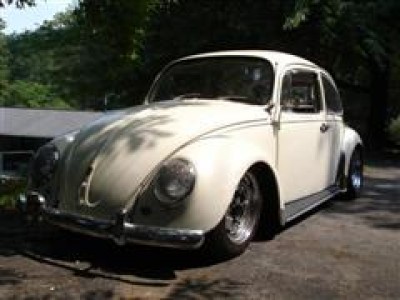

« Reply #5 on: November 03, 2008, 02:31:32 PM »
145/65/15's on stock rims 4 inch beam. 2 clicks rear 195/65/15 on 7 inch wide rims. Awesome turning radius but the beam hit everything on the road. But it looked cool. :lol:
Oh and it has drop spindles on it since the begining.

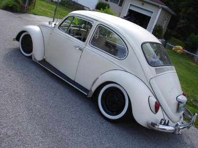

I like the stance of both of those cars.  My original plan was to run the stock rims with whitewalls.  I really want to run the pre-'67 smooth wheels rather than my stockers with the oval holes in them.  I would be totally happy if I could do that but I'm four lug and they are five.

« Reply #7 on: November 03, 2008, 03:08:14 PM »
I think they sell aftermarket smoothies in 4 lug. Put some caps on em and nobody could tell.
