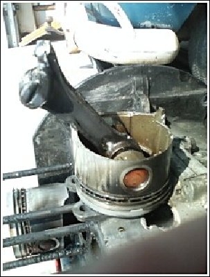

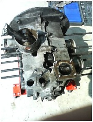

I'll have to get the number when I get home. Here is a few more pics.

« Reply #17 on: July 24, 2006, 01:27:55 PM »
dat don't look good! :shock:
Hello!
« Reply #18 on: July 24, 2006, 05:21:12 PM »
Hell Fire Bugz !!  A little J-B Weld and a clamp or two, You are on your way.
    By the looks of the side of the  piston, I belive that engine had been run red hot, burning a piston before the rod bearing gave up. I cannot belive you didn't hear all the "clattering" from the rod bearing long before it slung it out the case .  I think you already had a later model engine case. Clean off the top of a piston and tell me if it says  85.45mm and I would guess your case is a " B" or AE something. How close I'm I ?  Just checking my eyeballs
    Did you run out of oil ?  run without a fanbelt ?  . Be honest so you don't have to go looking for another cause.

« Reply #21 on: July 25, 2006, 04:59:33 PM »
Here is the info:  The case is H5358457 and the piston was 87.93.  I was just cruising about 65mph along Hwy 27 at about 3:00pm on a sunny hot saturday afternoon when it rattled about 30 sec. and then ceased.  There was pleanty of oil and the fanbelt was still good and tight.  But the oil cooler seals where a little melted looking.

« Reply #23 on: July 26, 2006, 01:32:37 AM »
Brian, Not that it makes any differents now ,the " H " cases were used on the type-1  in '67 (10mm nuts on oil pump) and  '68-'69.  The 87. 93mm jugs are after-market big bore.These were commonly called "88mm" It seemed that these "88"s ran hotter because of the very thin cly.  Your engine used to be a 1641 cc. with the "88s"
   Like I said before, the #4 piston showed signs of burning up before the rod let go. I bet #3 looked worse or should have. I would guess all the metal particals burning off the pistons ended up in the oil burning the rod bearings up.  #4 rod always seems to be the first to go.
   Melted oil cooler seals tells me that your engine was running way,way to hot for a while. If these seals melt down they can block the oil going through the cooler completly. So what happened ?  Why was the engine running red hot?  Wrong seals?  Bad seals ? Timing wrong?   Engine compartment seals gone ?   Heater pipes off fan housing ?   Low oil pressure ?
    Scott, Why do you not like "H" cases ?  Thats what your '67 came with.
             They seemed to run real good when built right ,but not my first choice for a modified today. My fake WW-2 Bug will be running a "H" case. I don't have a problem with that and besides I already had the case.
