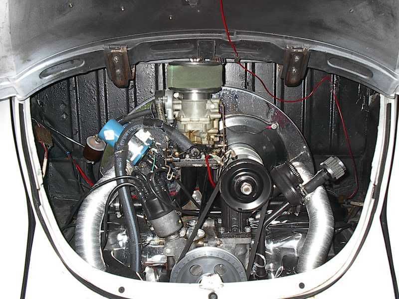

The "get up and go" may be to the gearing in the tranny.  I take it that your bug is a '65 0r '66 ?    If the tranny is the orignal, its geared for a 1200 cc 40 HP in '65  and a 1300cc 50 HP in '66.   Your duel port (stock ?)
is 1600cc  60 HP.  10-20HP gain is going to make a big difference. I truely belive that if you were running a 1600cc Single port (57HP) you would leave the line even faster but the Duel Port would get by you on the top end but not by a whole lot.
     Starting in '67 the trannys got a bit "long legged" in the gearing department.
     The fastest stock Bug I ever owned was my new '70 with the 1600cc Single Port . This was the last year in the USA for the Single Port.  That little varmit would put the speedo needle right in the middle of the turn signal indicator with ease on flat ground. :shock:

Yeah, it's a '66 with a duel port 1600..........7000 horse power :D
bug spray
« Reply #25 on: December 21, 2007, 07:16:50 PM »
Well !   I guess that anwsers your power question huh ?  I didn't know plug'n one little hole would do that. Shows you what I know. :lol:
Gehackt
bug spray
« Reply #26 on: December 21, 2007, 07:48:13 PM »
It was two little(big) holes! :D

« Reply #27 on: February 11, 2008, 11:05:22 PM »
I realize this is a little late... but I just wanted to add that I had a 200cfm bugspray on my beetle and it ran awesome... It was a stock 1600 with a C35 cam and an 009.. oh, and an extractor exhaust w/ a sideways pointing glasspack muffler. I had to redrill the mains with a #54 drill bit (if memory serves me... I'm pretty sure it was a 54, I think we tried 53 first) and as far as the choke, I'm pretty sure I had it set to have hardly any coke at all when it was cold... (or it would flood indeed) However, it started pretty well without it. When starting it I did have to nurse the throttle for about a minute or two, but after that it would burble happily away. I did have problems with it freezing up when it was around or below freezing and humid though... I would have to pull over halfway to work and either blow on it, or allow the radiant heat to melt the ice. I eventually drilled a hole in the rear tin and installed some heater hose to duct hot engine air from behind cyl 4 and direct it at the body of the carburetor. It did get take a little tinkering to get right... but it ran exceptionally well. I drove it for 10 months while working 2 jobs, often driving almost 100 miles a day.
(edit:  the carburetor had belonged to my coworker and I went over his house and salvaged it off an engine in the brush behind his barn and actually had to unstick it, disassemble it and glass-bead blast the steel parts, which were pitted slightly but not too bad. He also had one with larger valves, think it was dubbed the 300cfm version. and I had to use a spacer between the intake manifold and carburetor for the accelerator pump arm to clear the top of the generator)
the guy I bought it from asked me why I was selling it, and I answered "I don't want to drive it thru another winter"  - and it was the truth. I had two  lengths of aluminum preheater tubing running directly from where the hot air entered under where the rear seat would have been if I had one..  the Left one went under the driver's seat and sometimes I'd stuff it up my coat sleeve. The right one was by the tunnel and pointed up at the windscreen. Lack of heat was mostly due to aftermarket, non finned heater boxes and an ill-fitting hood that didn't seal well. sold it to buy an '89 jetta that I've been driving for almost 5 years and 100k miles.
