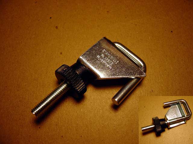

Next time you don't have a sixteen year old and a pencil handy, try this fuel hose clamp: http://www.toolsource.com/steel-fuel-hose-clamp-p-78872.html
It won't damage the hose, and you can use it before you disconnect the fuel line and avoid spilling gas on yourself.

I look at that and think, I have most of the parts to make that.
Thanks for the post....

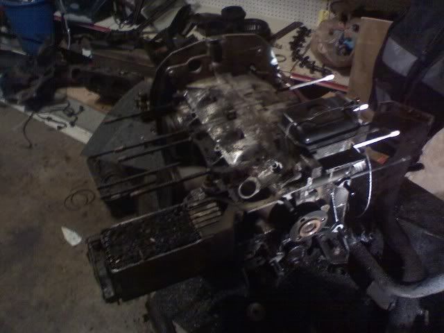

I got the head and jugs off of cylinders 1 and 2 last night... and I'm hoping to have cylinders 3 and 4 apart tonight...
Cylinder #1 didnt look very good... I'm amazed it even had good pressure to be honest. The piston had a spot in the top of it where sometime in the past it had smacked a valve. the valves look ok,which leads me to think someone pulled the head and replaced the valve without replacing the piston as well.  :lol:  The piston itself also had some pretty good gouges down the sides of it, where it had scraped the cylinder walls pretty good at some point. The piston rings themselves looked ok, however the two upper rings were aligned wrong (their gaps were at the same point)
Of course this is just observational for now, since if I rebuild this motor I will replace these parts anyways.

ok, so now the motor is pretty much disassembled, and heres what I found.

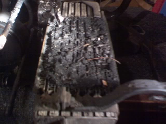

Second: my oil cooler vents were clogged like crazy with some of that extremely brittle insulation stuff...not sure where it came from.

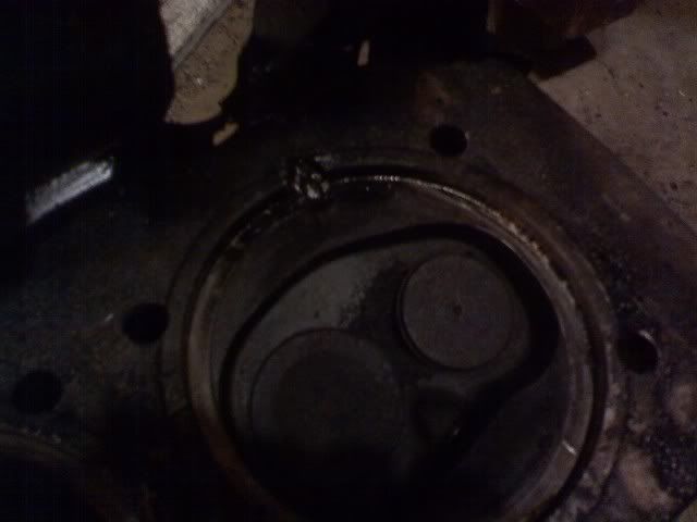

third Remember the cylinder that basically had no ompression? Well, THAT was the source of why my motor was so loud all right! it appears some time ago (possibly with previous owner or the one before) someone might have dropped a nut or something down the intake, and never went after it... have you ever wanted to know what it does when something hard like that starts banging around in your cylinder? well, apparently it keeps digging and digging till it finally finds a way out. and on mine all the damage was dont to the head itself as you can see here between the valves and along the sealing edge where the cylinder meets the head.
Well there you have it!

I just won a bet on what you would find on the cly. with no compression. This is not a uncommon thing. No loose parts did that damage.  The little alumn. sealing shim burned out leaving a gap between the head and cly.
 Everytime it fired on that cly. It acted like a blow torch and burned a wedge out of the head.  Head time. God only knows what else was running around in the engine.
      I think the fuzzy stuff on your cooler is the remains of a foam comp. seal that got gobble up by the fan at one time.
      More than likey all this damage was caused by high heat due to wrong Ing. timing and  blocked air cooling, no comp.seal etc.etc.

Also I looked at the pic. a little closer and it looks like the exhaust valve seat  has " left the building" not that this matters due to the pie wedge burned out of the head.

« Reply #28 on: June 27, 2008, 10:45:46 AM »
Quote from: "ASBug"
If you can make one for about $12, I'd buy it from you too. Here's a larger photo.
