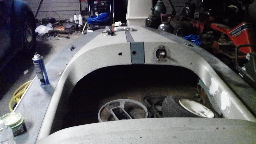

So I picked this thing up about 2 years ago while I was still working on the house. It was a really great deal and I had been researching building something like a mini-max(old pop-mech. design) or something. It has been sitting in my garage waiting for me to get a free moment. Well, when Megan and I went to Disney, I picked up some paint from West Marine and when I got back, I flipped the boat and sanded/painted the bottom. I just got it back right side up tonight and put a coat of spar varnish on it. I'm not sure how varnish will do on fiberglass, but the metal flake was getting really rough (like 60-100 grit) and I didn't want to put epoxy on since its non-UV protected. I found the varnish for $.50/pint and decided, what the heck. It turned out really nicely and I plan on getting a motor and an interior in it pretty soon.

I don't know what brand mine is and I'm not sure what mine had on it at one time, but whatever it is can't be very heavy! I am looking at putting an older 35hp 2 stroke evinrude on it. The transom needs some work (the top and bottom have split around the transom) so I have some 1/4" plate that I'm going to use to reinforce it and build it up to accept a 20" shaft outboard (the transom is currently 16" high).

I've heard of people putting 9.9hp- 40 or 50hp motors on these little boats. I was looking in the 25-35hp range because its hard to find a 15hp with controls locally. Most all small outboards are tiller steer. I don't have to use all the horse power and with my luck, half of those horses would be lame anyway. I rented a little boat at disney 2 years ago shortly after I picked this one up and the 9.9 seemed way under powered. It wanted to go faster, but it could never get up on plane. I want more than that, especially if I'm going to be around other boats (that aren't underpowered tiny boats- like at Disney).
