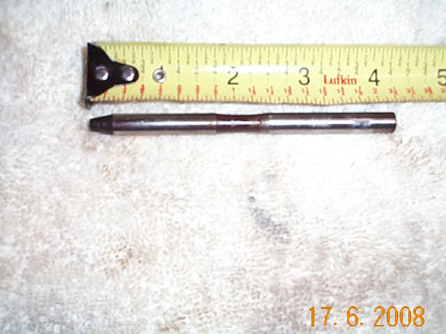

I'll take the rod aout and measure it.  For a regular pump, what should the length be?

Dang !! You just had to ask that question :lol:  :lol:
           The only pump rod I have laying around measures  approx. 4 1/2 inches in lenght. I'm going to assume this rod is for the vertical pump. If you take the pump off, turn the engine by hand until the rod reaches max . height.( it doesn't move much) The 4 1/2 inch. rod should stick up about
1/2 inch from the plastic block.  The angle pump rod is shorter and just barely sticks out.

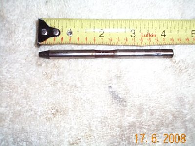

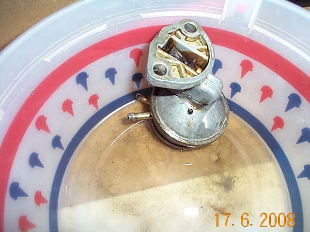

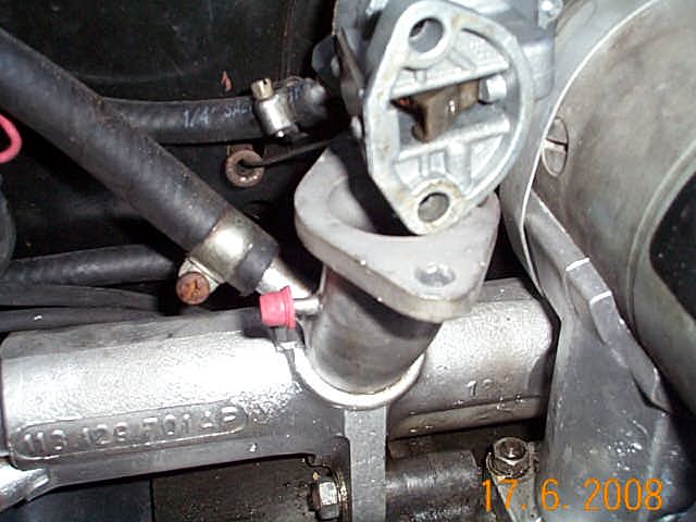

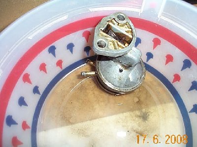

« Reply #25 on: June 18, 2008, 10:25:20 PM »
Well, My rod is only 4.25 inches!
I guess that could account for a problimatic pump set up.  I have attached some photos.
Thanks,
4.25  inches
new pump base
new pump

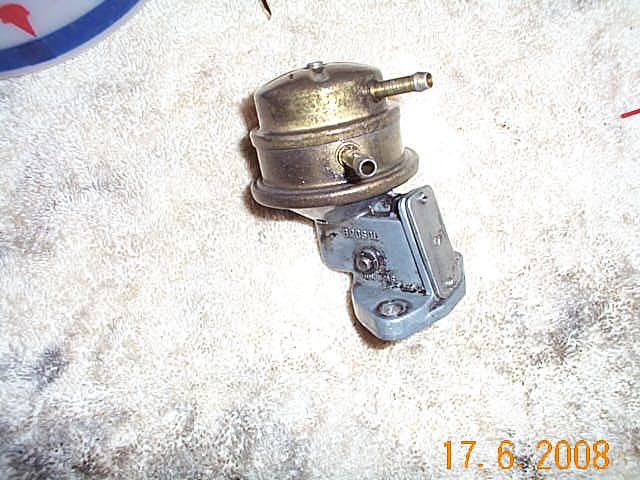

Wierd symptom...1972 AS bug.
« Reply #26 on: June 18, 2008, 10:27:35 PM »
Here is the old pump.

« Reply #27 on: June 19, 2008, 08:18:30 AM »
Your new pump shows , if I'm looking at it right, that the lever is about level with the bottom of the casting. Right ?  If so it should work with the short rod if something in the workings of this pump is not weird
 , BUT I have never seen a vertical pump that was set up like this. I'm not sure what it is for.   Short rod= angle pump.    Long rod= type-1 pump just like your old pump.
    You have the long rod I belive. I gave you the wrong info . 4.25(4 1/4") is correct.
     Hold off until I can get hold of another rod that I KNOW came off of a angle pump set-up so I can compare. My orig. shop manuel doesn't give  rod measurements.

« Reply #28 on: June 19, 2008, 08:50:24 AM »
Yes, it appears that the old pump does sit in slightly from the bottom, BUT the new pump actually "pumps" about the same place as the old pump.  The new pump just "free-hangs" lower than the original pump. It does enguage slightly higher than the original pump.  This with the 2 thick gaskets I had under it was causing it to not pump as things expanded  - I think.
Any one ever seen this type pump before?
The top looks simular to the "old style" pump shown in my haynes manual on page 4-4.  It appears that the head is off by 90 deg.
