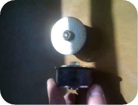

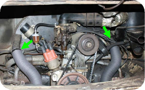

So when I purchased my bus a couple weeks ago the guy I bought it from told me that the heat was always on. Do to rusted pipes the heat also pumps a good amount of carbon monoxide into the cab. My brother suggest I purchase a Canary and hang its cage from the rearview but I decided it would probably be much cleaner to just plug the heater from the start. I've got two plugs someone gave me but I'm not sure exactly where to plug in the heat system (picture below). The only place they appear to fit I've noted on the other picture below. I'm concern about blocking the wrong air flow and my motor overheating. Can anyone tell me if they've done this before? Or suggest another way for me to block the heat?

You could do something really clever and repair the heater box's. If your box's are rusted/burned out where they connect to the muffler ,you can buy a little repair kit to replace the ends only. New heater box's are terrible. They do not fit well and don't heat well and cost way to much money and they have to be for a bus/van . Box's from a bug are different in the way they are hooked up to the levers.
     You can block the air pipes shown in you pic, but make sure that the plugs will not fall out. It would cost you about 50-60% of your engine cooling air. Not good and just in time for summer driving.
      You might check under the van and see if someone wired the heaters on for winter due to broken cables. If so ,cut them loose. A very common thing to do. I hope this helps.

If you do this, your heat exchangers WILL overheat.  I tried this last summer and melted some plastic in the beetle.
I would just disconnect the flexable hose on the end of the heat exchangers and put those plugs in the drawer.
Put some Alabama Chrome (duct tape) on the end of the hard metal pipe (body side) and seal it off & presto no heater.  (It isn't like the heat is usefull any way.

Do what to make a exchanger overheat. ?Melted what plastic? If the heater boxes are in normal, good operating condition and turn them off with the cables there is no air passing through the boxes. The air is stalled out at the flap inside the box. What would make them overheat ?  If you are melting something you have problem.  If you pull the flex pipes off the heater box under the car and the heater box flaps are still lock open you will loose a lot cooling air. That be like taking the pipes off the fan housing and leaving them open. Not a good thing for summer driving around here unless you just love to burn up stuff.

I've never seen one get hot enough to melt anything, but they will get a little hotter with the air to them disconnected.  When you close the flap to cut the hot (  :lol:  ) air off to the cab, a small amount of air continues to flow across the heat sink and out the vent behind the flap.

That little vent on top of the box is a baby's breath. The worse exhaust smell you get comes from the rusted outer sheet metal around the outlet pipe right at the muffler connection along with a hole in the muffler or a rusted out heat riser pipe on the intake where the cooling fan picks it up and feeds it to the air going through the heater box. I have seen a very few cracks in the boxes in 40 + years and these were not caused by blocking off the air.

I slid under it when I got of work today and could see where the previous owner had used old coat hangers to rig the heat exchanger on all the time. When I unhooked them I was able cut off the heat. I used a heat shield exhaust tape I had left over from my motorcycle to help seal some of the leaks around the heat exchanger and it appears to have stopped almost all of the exhaust smell -heat. I appreciate everyones advice.
