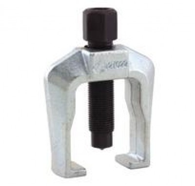

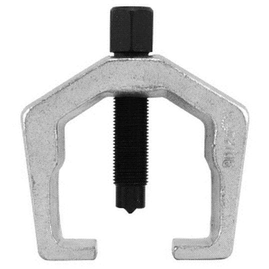

Something like one of the tools below should work.  They call them Pitman arm pullers or tie rod end pullers . . . but I've used 'em on ball joints before.  As long as you can get one to fit in there, it'll pop the joint apart in a heartbeat.  You can get them from Autozone for 12 or 13 bucks, or pay a 100% refundable deposit and borrow one from them.

The reason it won't come out is some German auto worker torqued the nut down and pulled the tapered end of the joint tight into the tapered hole back in 1970 or 71.  On top of the pressure that it was pulled into the hole with back then, it's had nearly 40 years to fuse itself together.  The reason the other one came loose was that when they laid it on the heavy metal table and whacked on the side of the arm with a hammer, it temporarly distored the tapered hole and spit the tapered shaft out kind'a like when you squeeze a watermellon seed between your fingers.  Without a solid surface behid it to stop the shock wave (such as when it's still on the car) the hammer whacks don't distort the whole that much.
Take a puller like one shown above, slide the "hooks" over the arm and center the bolt on the shaft (after you've removed the nut of course) and tighten the bolt on the puller.  It'll usually pop them loose without a lot of effort.

Ok  I buried the hatchet,   in my foot,  ow,  Safety first.  I went to autozone and they had a puller,  Pop goes the weasel.   its off.   I  must be pretty strong.  I broke off 3 bolts,  Got some shiny new ones.   Even got some to replace the ones that did not break.  Replacing perfectly worn and rusty bolts is something new for me,   Now I need to go for a shimy and shake down  drive
