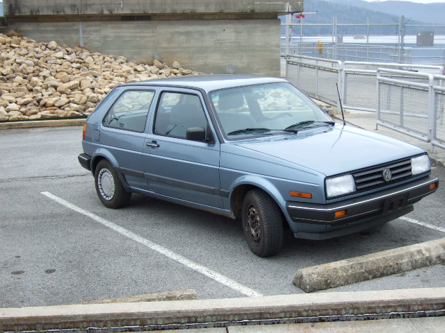

I just bought my first VW Wednesday, a 1990 Golf GL w/ 90k. Paint and interior are still in good shape, just a few rust spots here and there. I have subsequently fell in love with the car and am currently doing maintenance on it. I was aproached by a stranger in the local parts store who saw me pull up who said he owned several VWs himself and that I should change the timing belt as soon as possible. I feel very confident in my skills as a mechanic, but don't think I'm up to this task. A local repair shop estimated me at $450 for a new belt, water pump, V-belts, and labor. My question is: Should I pay to have this done, try it myself, or not worry about it. I am a Electrician/Industrial Mechanic/ Machinist/ Welder/ Heavy Equipment Operator by trade so I know my way around a tool shop. Any Help???

Does Rick have his own shop or does he do work on the side. Also when is he gonna be back and how can I contact him. I can do alot of repairs, but I've never taken the timing belt off an engine, so it would be best to let it be done by a more experienced hand. THX guys. I will post pictures later if anyone is interested. I know it's not a classic VW, but I still just love the thing. It's peppy and a blast to drive. I'll even run errands for my wife again... lol

1990 VW Golf - 1.8L - 5 speed
