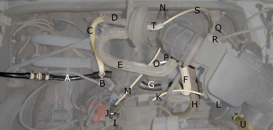

14) Where does the little vacumme line that is t'ed off the brake booster line and then comes back into the engine compartment go to?
-I have the choices of the back of the dual can on my distributor advance or the canister that is at the heat tube that comes off the #3 cyl. area...
-It is cut shor of either of them and is plugged with a small bolt there.
I checked the lights in the dash, the bulbs seem good, the wiring seems good, and I am wondering if the jumper from the light switch is working, that is a pain to get to....

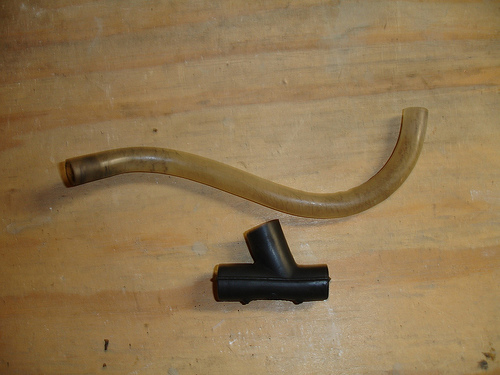

The line from the brake booster connects to a one-way valve and plugs into the rubber tee on the driver's side of the air intake plenum. A plastic hose plugs into the top of the tee and goes to the decel valve mounted on the firewall. At least that's the way it is on mine, I'm assuming it's the same in '75.
Check your rubber tee real good for cracks, they are often a good source of vacuum leaks. I might have a good spare if you need it.

Russ, I checked the "t" and it was fine.
The little line that I am refering to is a small 1/4"'ish vaccume line that tees off the main vaccume line to the booster just past the check valve in the main line, then it reroutes back through a grommet in the firewall and goes to one of the 2 places that I have mentioned.
I replaced most all the vaccume lines except the LARGE one from the oil vapor can.  It appears to be OK and I couldn't find a hose at the house that would fit it.
I did all this to find the vaccume leak that was causing my engine to die after a few seconds of starting, after replacing all but the main booster line, I figgured out that I didn't put the pigtail back on the MAF sensor....
Run off the excess pressure in the rails and then would go dead....Classic.
Any way I unplugged the pig tail when I was installing the NEW engine seal...
Any way, if you still have no idea which hose I am talking about, let me know.  It is a small, tiny vaccume hose, like the one that drives your vaccume advance on the bus.

« Reply #39 on: November 29, 2008, 08:26:28 PM »
I can't visualize the line you're talking about. Can't remember if it's been mentioned before, but have you seen Ratwell's vacuum hose diagram page? Of course, his reference is a 1978 Federal engine with a manual trans just like mine, and I am not aware of what's different between it and a 1975 FI engine.
You might have some extra/different hoses as well since it's an automatic that I don't know about, too. In my box of parts from Anthony there's a weird looking molded plastic hose that has a similar part number to the hose going from the decel valve to the S-boot, but it doesn't fit my setup.

I appear to have an early L-Jettronic system with the exception of this small vaccume tube.
"The early EGR valve has a vacuum hose for activation and an electrical connection which means the early FI system has a special harness in addition to it having a 6-pin AFM plug instead of 7-pin. The electrical connection leads to a microswitch on the throttle body which closes the valve at idle and WOT. " -RATWELL'S site.
My EGR isnt vaccumed at all, I am wondering if this is causing my sputtering....(does WOT mean Wide open throttle?)
I am going to install an X in the current line, it appears that there should have been a T that was running the retard on the manifold to air cleaner hose, currently it is just a straight hose.
I am believing that the small hose that comes off the t just past the brake check valve went to the EGR at one time...  I am planning on installing an X in the manifold to breather line and wireing it us as shown in the RATWELL site and seeing if this cures my sputtering under load problem.
Does this sound like a likely culprit?
