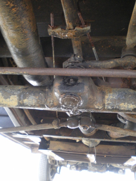

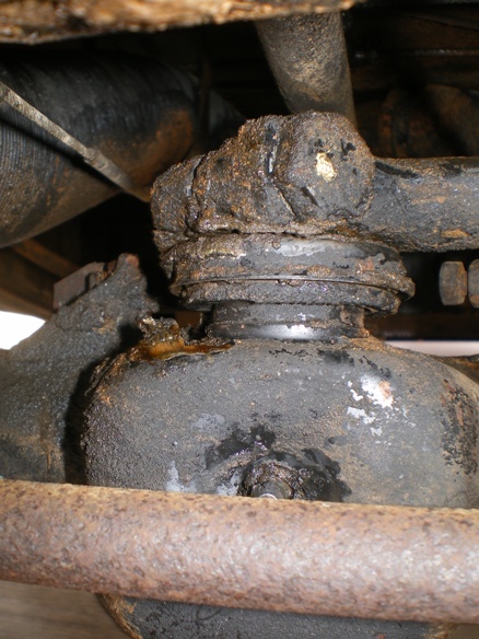

Ok, I though I might take a picture of what I think is the problem with his steering. I read somewhere that when it comes to steering up and down is bad side to side good. Well, this part in the picture goes up and down when you turn the wheel. What parts will I need to fix this or have this fixed. Thanks for the help.

Yep, that kit has all the parts to repair the swing lever.  I got mine from CIP1.com a couple of years back when I repaired Homer the Super Bus.
http://www2.cip1.com/ProductDetails.asp?ProductCode=VWC%2D211%2D498%2D171%2DA
The old bushings are a real pain to remove and its pretty easy to damage the new ones installing them if you get in a hurry.  Read up on the proceedure before you start, have a manual with you while you are doing it and take your time.  It's not an impossible DIY project, but it's not easy.
