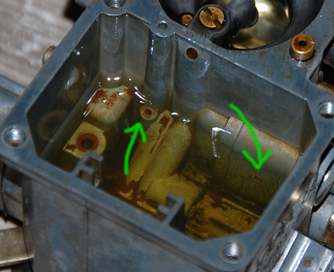

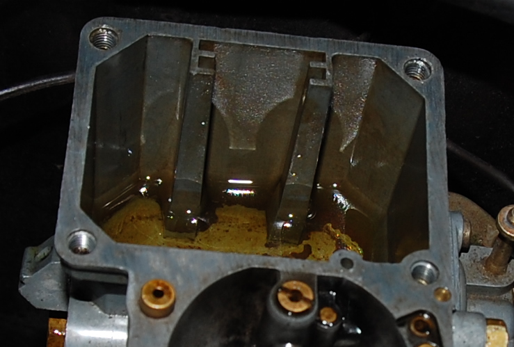

I took the top off the carb this morning and left it for the day to see how low the float went.  Hopefully this would tell me if the leak was due to the bowl being too full or if there was another problem.  Got back this evening and the fuel level was pretty low (see "low fuel level" pic).  This implies to me that the leak is not due to overfilling the bowl via a bad valve.
I took the carb off the car (again) and had a good look inside it.  The fuel level was just below two holes in the carb body (see carb holes picture), so my Sherlock Holmes skills lead me to believe that the gas is leaking through one of those when it shouldn't be.  I can't tell by looking at the carb what those two holes do.  Any ideas?

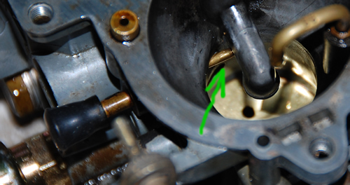

When I saw fuel leaking before (when it was on the car) it looked like it was coming from the bit I've put an arrow to in the "leaky bit" picture.  I thought this was a vacuum connection for a vacuum distributor but I'm not really sure.

Leaky bit

Low fuel level in bowl

BTW, looks like I was right about that brass port being a vacuum port:
http://www.thesamba.com/vw/forum/viewtopic.php?t=185095
So.. why on earth is gas coming through it?
