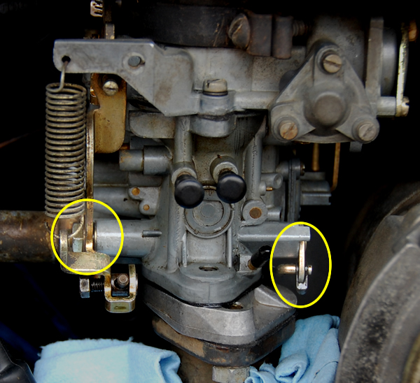

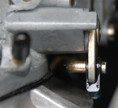

No luck, gas is still leaking into the manifold and outside the carb.  I've figured out where it's leaking outside the carb now - it's slowly dripping out of the ends of the rod that goes through the butterfly valve (has the throttle bit on the left and connects to the pump on the right).  I took the top off the carb again and saw where it was dripping into the intake - there's a small brass metal bar coming out of the left hand side and sits just under the main gas injector bit (sorry for the poor terminology!).  If I push the float down, lots of gas comes out.. so I'm guessing this is some kind of overflow from the gas chamber.

Because a picture can tell a thousand words... here's the carb, and the two points that gas leaks out...
Drip drip drip...

You have some wear on the shaft causing the leak, but there is something else that is going on. Gas has to be coming from somewhere causing it to pile up on the butterfly. Not being there to look at it I can't be  sure whats wrong,
 but I still think you have a problem with the needle and seat(float valve) or the float . Like Big Dummy said maybe its just worn out but I don't know.
      You have the 30-31 carb. conversion with the adapter. If you replace the carb , replace it with carb just like the old one.  Your engine is suppose to have a 34mm carb but for god sake don't buy one of those.
