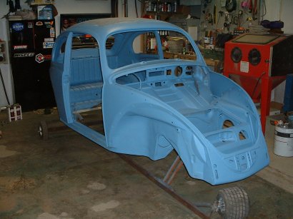

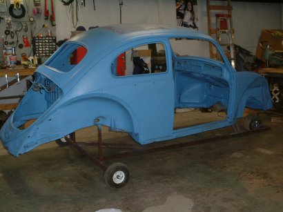

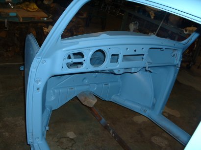

I just took my 64 bug body and had it soda blasted.  they used "Baking Soda" instead of sand or pellets,   That is the way to go!!!  MAN !,  that thing looks good,  soda doesnt leave pitting like sand, doesnt create heat from friction like sand.  therefor, does not warp the metal , or leave that rough texture like sand blasting does.  they did the whole body, inside and out.  just took about 3 months work off my back.  yep, its been a good day.

 Here are a couple pics..  I sprayed it as soon as I got it home with some basecoat, just to keep it from rusting back so quick.
