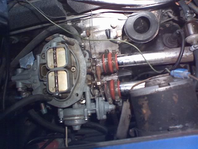

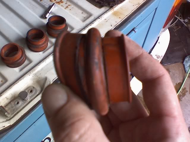

well, I noticed last night that the rubber boots on my intake piping looked a little cracked and worn out, so I decided to replace them today. it was only then that I saw just how rotted they really were!  :shock:
Heres the new boots on the intake piping:
And heres what the old ones looked like after removing them.... You think they leaked much?  :lol:
I havent had the chance to start it up yet to see if there is any difference, but I am betting it will be noticeable lol I also bought some new exhaust port crushrings to put on hopefully this weekend...
ALSO..... Can anyone help me figure out what kind of carb I have?? all I know is that there is a tag on it that says L 6549

Yep, This will cause a ldle problem.  Your carb is a Holley/Weber progressive carb and was used in the kits to convert old Type-4 twin carb and injected engines. Common.
    Good luck on your exhaust rings and DO NOT break any studs off . [-o<  [-o<
