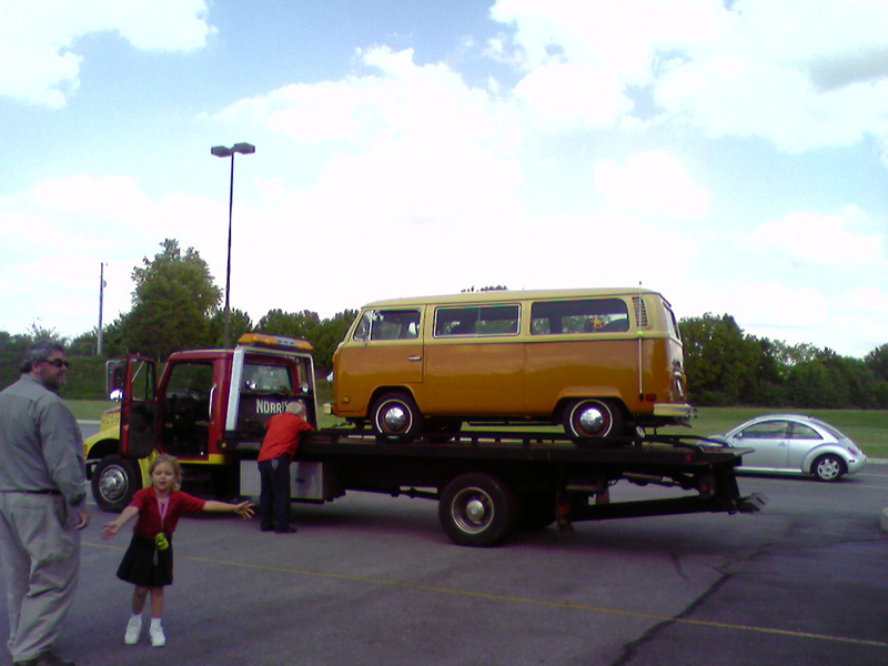

For the past several days, I have been noticing that my '78 has been wanting to stall out at idle (at red lights, in my daughter's school drop-off line, etc.). Today, it was doing it as well, so I stopped off at my local Import Parts store (local, as in 20 miles from home) to get some advice and prices on parts. When I was done, I was heading home when Oscar just died while going down the road. I had enough momentum to pull into a parking lot to see what was wrong. I couldn't tell what was wrong.
Back up to yesterday...thinking that the Pertronix was "going bad", I put the points and condenser back in. I didn't know that the Pertronix, when bad, just dies without warning. It still wanted to stall even with the points in. I replaced the dist. cap and rotor button as well. Still wanted to stall. Made sure that all the vaccuum hoses were connected (they were replaced back in March). I have yet to get in there and check out the FI components. I don't have a fuel pressure gauge, but I am going to get a gauge and some hose and make one ASAP.
Back to today...my wife had called yesterday and cancelled our Allstate RV Roadhelp membership. The assistant told her that we were paid up till September 29th. Wouldn't you know that I had to use a tow just a few days before it expired and one day after cancelling? What luck. I think I might call them back and tell them to forget cancelling our membership. Anyway, Oscar is home and in my garage. I want to start diagnosing what could be wrong. The guy at the Import store, who I buy all my parts from also has a shop in the same building. I asked him if he works on the FI models. He told me yeah, he does. But what he does is convert them to carbueration. I don't want that. He also said that if he doesn't convert, he just replaces part by part until the right part fixes it. I told him that sounded awfully expensive. He did give me a box of FI parts that were given to him for me to try out, use what I need, pay for what I use, and give him back the rest.
