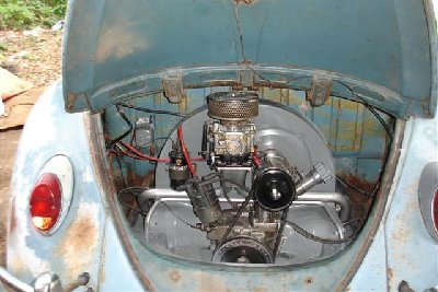

Same motor I had in the 67 just a few changes:
1641 cc
mahle forged 87mm pistons
Stock crank and rods
Balanced and lightened flywheel
Cb Performance equalizer pulley system
Bigvalve(40mm) SP heads.
HD valve springs,solid shaft rockers,elephant feet adjusters
Scat C-35 cam
Zenith NDIX single carb with manuel choke
Not a speedster by any means but will climb any hill with ease. :lol:
Way more solid pulling motor than the 1641 with duel carbs and way easier to tune.Not to mention not as loud.
Next motor 1904 SP. :shock: I'm really hooked on this Zenith set up and I've tried many different carb setups.
This motor was born from a few conversations with The Godfather. Instead of building the 1800 I built the smaller version and will now build the big brother of the same design for the 67.

Scott,  You are very close. Can you say 76mm stroker with Decked 87's or "machined in"   88-90 mm stroker pistons ?  You already have the "other" stuff.    I had a hunch you would like that Zenith.  I love them as a single carb set up. Soooooo simple to deal with. I bet this SP set up would have a lot of Grunt on the bottom end along with desent fuel mileage to boot. I'm kicking this idea around myselve for Albert deAllison
Reinhart would then get the 1600 stocker. :-k  :-k

The 76 crank will be the next motor I've already got the case,heads and pistons ready. I never relized what a lil beast of a motor I had put together until I put the Zenith on. It's a lil stump puller ,and it makes those nice lump lump cam sound now. :D
Zeniths have been poppin up all over Samba for cheap!!! I'll Keep an eye open for another with the manuel choke for ya. Why would anyone want to mess with duels when they have these???Thanks for the tip big guy.
