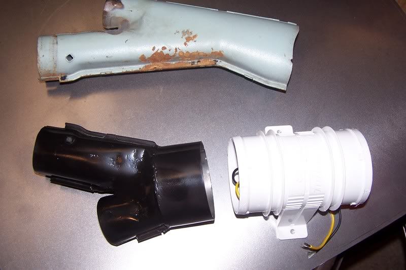

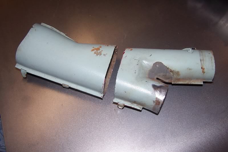

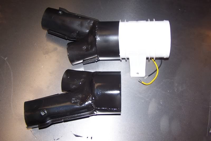

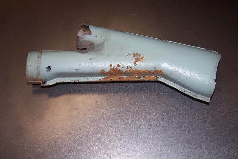

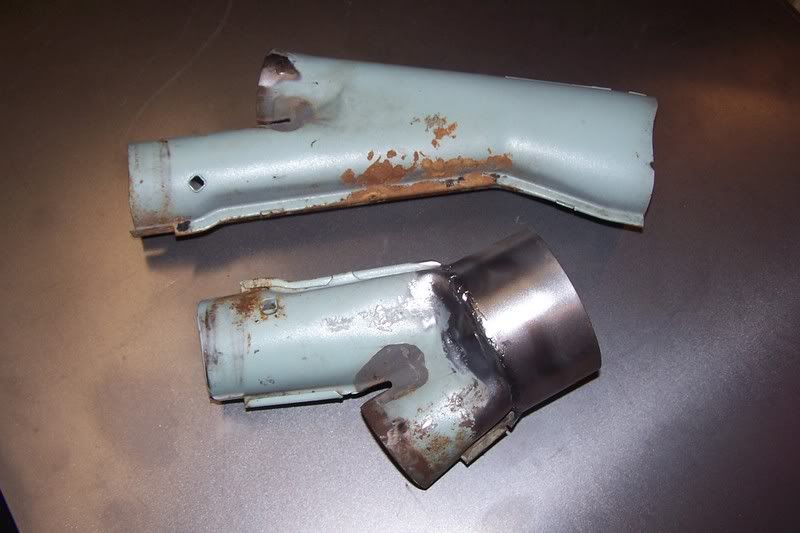

You know what this is right?
a little modification and....
Wala......I have forced heat.
At 20 degrees outside. 20 minutes and it's a comfortable 70 degrees in the cabin!

Does the white section  filter out the burnt oil smell?   SC

My Heat exchangers are in good condition. So there's no smelly burnt oil smell.....and it doesn't matter if you pull your warm air through or let the stock set up do the work, if your exchangers are bad, your gonna get the smoke!

Good job Joe, Those inline blowers are a great improvement over the old "Squirrel cage" outfit we used long ago.  If I remember correctly we used blowers off '55-'56 Fords. This was before anybody came up with a "kit"
  I belive I saw the "how to" in a copy of  "Foreign Car Guide" years ago. People had to keep a bottle of Windex in the car to clean the oil off the windows when all they had was the "Dirty Air" heater boxes. But you were warm. Every time you hit standing water or drove in a driving rain you had a sauna bath.  Who said driving a Bug back then wasn't a trip :lol:  :lol:
