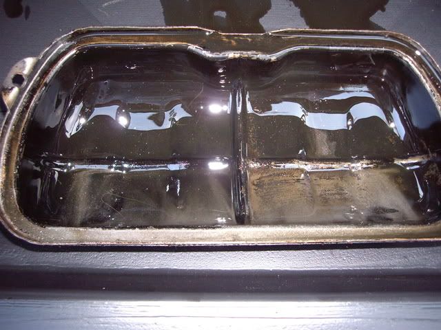

« Reply #10 on: July 27, 2008, 08:23:51 PM »
here are some pictures and info.
pulled off the head to see if more oil had pooled there, and it seemed that it had. pured most of the oil out and heres a picture of some metal flakes in the cover.

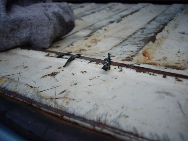

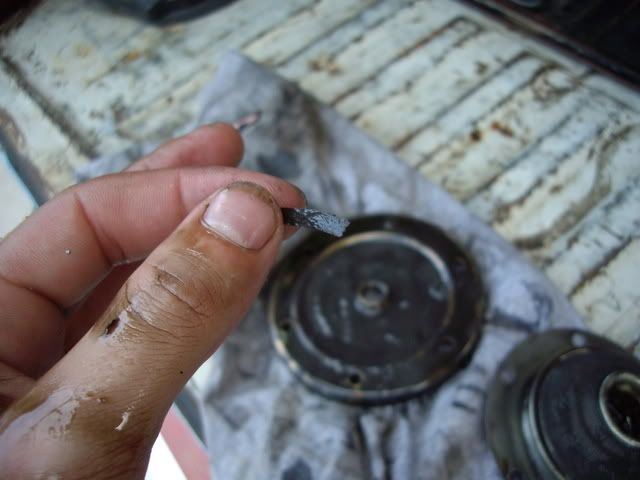

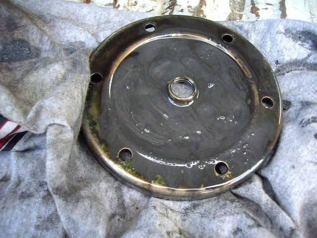

Decided to drain the oil, and check inside a bit.
pulled the drain cover to find crap in it. looks like fine metal, and peices of something. maybe a shim...
dosnt look good, but i didnt see anything brassy.

« Reply #11 on: July 27, 2008, 10:32:30 PM »
Is that stuff aluminum ?    Stick a magnet on it.  It might be from a piston skirt. Has this engine ever dropped a valve or burned up a piston and was" patched" up without spliting the case ?  Just a guess. :-k  :-k
oil in my head
« Reply #12 on: July 28, 2008, 08:00:25 AM »
I must agree, looks kinda like a chunk o' ring and the fine suff looks like aluminum.  Magnet time.
