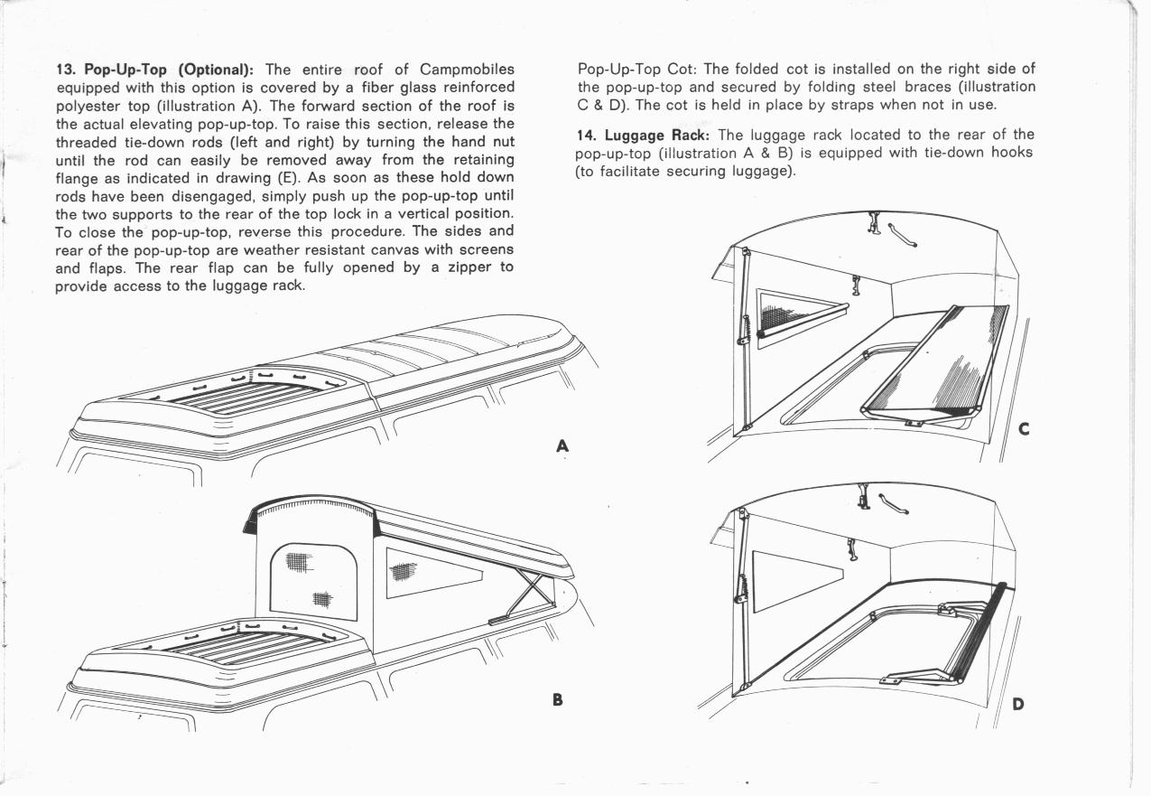

Welcome, the procedure for opening and closing the pop top is described on page 12 of the Westfalia manual that came with the bus. If you do not have one, The Samba has one scanned: http://www.thesamba.com/vw/archives/manuals/manuals70westy.php

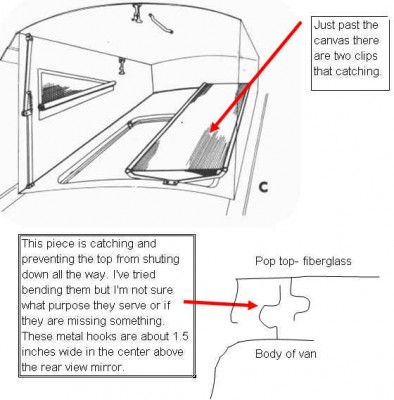

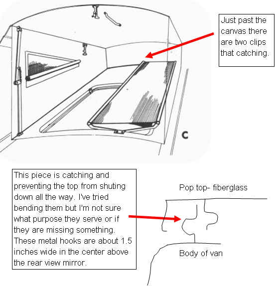

I've attached this rough illustration to try and describe my issue with the pop-top better.  Let me know if it appears that a piece is warped or if you think I'm missing something. I'll try and add an actual picture of it this weekend.  Thanks

The bracket on the front left of the pop-top was broken and the two s shaped hooks in the front above the rear view mirror where bent and catching. I found a junked 1970 Campmobile in Maryville last weekend and was able to pull them off. If you need parts the guy would probably sale a whole thing for $100.
