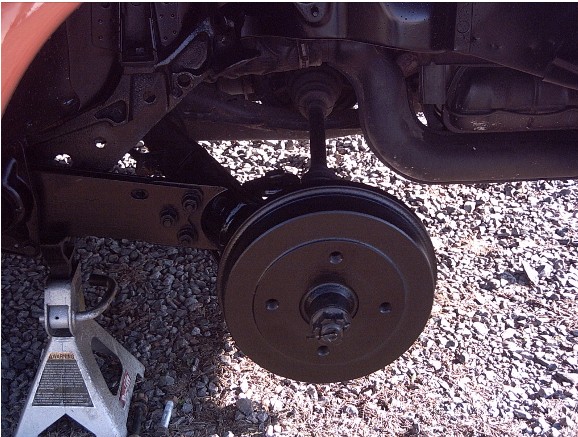

Check it out everyone, amazing what sanding some rust out and painting something makes it look new, and yes david I know u will say something about the gloss, but as for this I wanted it to be gloss, but the engine not. And I will be taking the engine out again because MACCO painted my engine up and I want to repaint where there spatter is. Flat black for that.. I love that gloss look. Look SMelly.. NOTICE the JACK STANDS. NOthing but SAFETY.... :lol:
