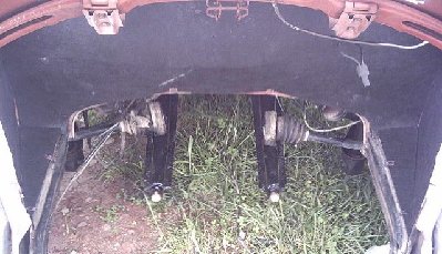

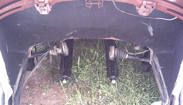

OK here we go. This is the best I could do. I heated up the material with a heat gun " hair dryer" and installed it, but most of the sharp thingys didn't want to go through and the ones that did was like man rippin the board. Anyway it is done as far as i am concered and it really doesn't look that bad. i was going to spray the thing down with satin semi gloss or may just clean it up. i manged to get atleast 4 hooks through and she seems tight... so anyway here we go. let me know what ya think david..

Looks  OK to me as long as it stays put and not in the fan.  Consider the dist. sold. He will pay me at BP-7 if you don`t come up. You need to make if you can. You would learn a lot and gain a lot of info besides being able to see some fantastic cars. Come on and bring your camera. Its an Order  :wink:
