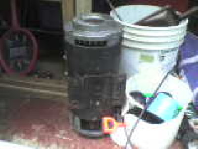

I have this lift truck motor  but cant figure out how to connect it  to my tranny,  Any Ideas,  It does not have a motor shaft

It appears that you are going to have modify the mainshaft from your transmission to fit the splines of the electric motor then come up with way to mount the motor to the transmission itselve. You are on your on. :roll:

It would be cool of I could get a sleeve to fit over the transmission shaft that would fit in to this thing.
I need to get a broke transmission to figure out what size every thing needs to be,  Anyone have a toasted or flambe'd transmission I can use for R&D?  SC

If you can get your hands on a transaxle, take it and the motor to a good machine shop . . . most GOOD machine shops should be able to fabricate you a plate to mount the motor on the tranny and a shaft or sleeve to couple them together.
