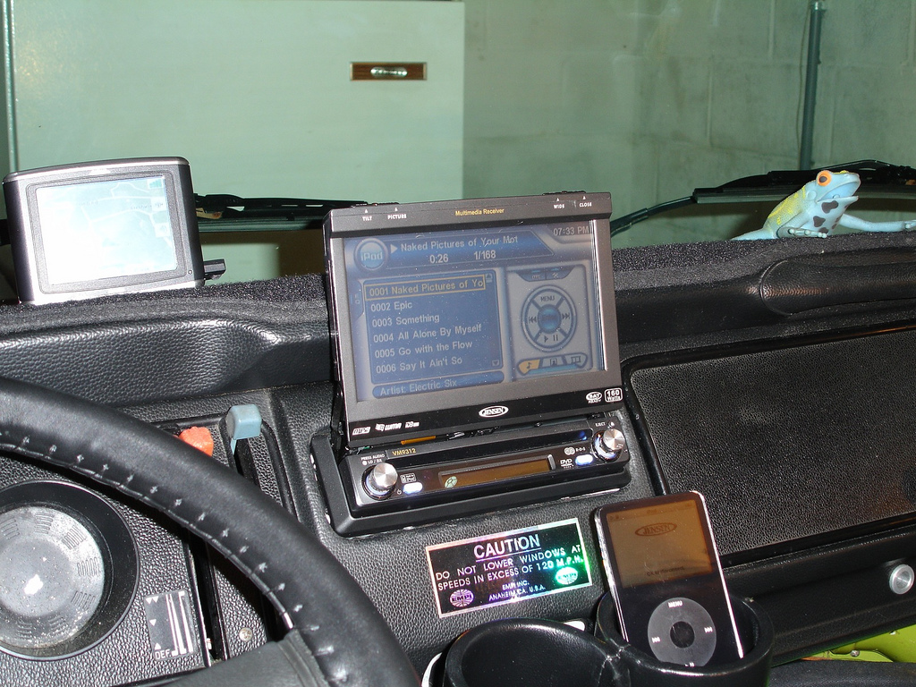

The radio opening in the dash is slightly smaller than the standard DIN size, so to make it fit you do have to cut the opening slightly to make a modern radio fit. This can be done without mutilating things too badly, I've got a Jensen stereo with a retractable 7" LCD screen and it fits great.
Also instead of making a mold of your glovebox, I suggest just buying an ABS plastic glovebox. If yours is still original then chances are the pasteboard is deteriorating anyways.

Dang Russ... the bus always looked nice.  I had no idea you were rolling with that much technology.  Looks pretty clean, not too obtrusive.....

Affirmative.  I think that the late model dashes are o.k. with a little bit of modern touch.  Russ's install there looks great.  But, I wanna kick somebody in the hind parts when i see a beautiful painted dash with a scrolling JVC screen saying "hello" to you when you turn the key on.... :roll:
