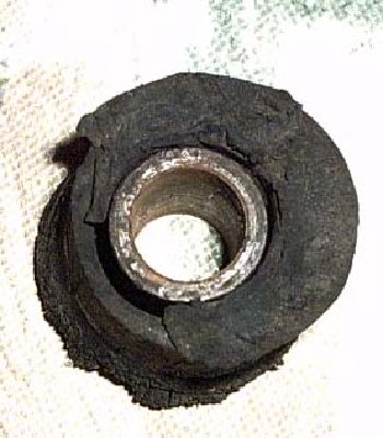

New Question
« Reply #14 on: November 06, 2005, 12:53:48 PM »
Does anyone  here know where I can get someone to press out my bushings out of my control arms and press new ones in? Also on a 71 super don't the strut housing separate from the spindle?? Also David the bushings on the sway bar look new but I am going to reaplace them. Also the ball joints well at least the side I have torn down is wobbly like heck.. So I am guessing that since the boot is broken I can replace the whole ball joint and get better handling along with the new bushings and struts... Anything I am missing here? Here is a pic of the steering damper bushing.. I think this is worn out...
