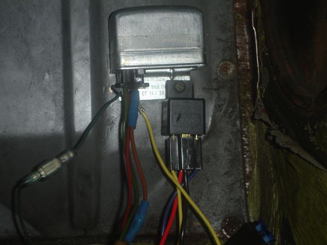

I think this is a big help to older VWs, and buses in particular since they are longer.
When you think about how the factory starting system is wired up, current has to travel from the battery up through to the front fuse block, then through the ignition switch and then all the way back to the starter solenoid. Over time, wiring deteriorates, which adds resistance to the lines and on particularly hot days when you've been driving a while, your VW may not start up at all until things cool down again.

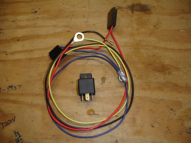

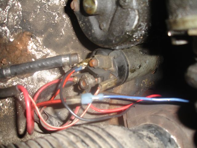

When you install the relay, it now only takes a minimal amount of amps to travel from the switch to the relay, which closes and provides current directly from the battery to the starter. The result is much easier starting. I installed one tonight and was amazed at how much better it worked. No more grinding away on the starter, it started up immediately every time.
Bosch makes a relay kit you can pick up for around $20 from various retailers like Bus Depot or Wolfsburg West. Or, you can make your own with a standard automotive relay, some wires, and some connectors.
I mounted mine right beneath the voltage regulator on the right hand side of the engine compartment, against the firewall. The wiring was routed through a grommet to the starter below. Installation was pretty easy. Every bus probably needs this sooner or later.
