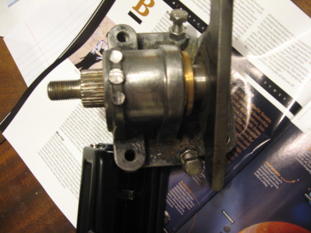

I got this anti shimmy bushing for the sterring.  30 bucks for the parts 10 to ship.   I got it pressed in at our shop at work  but it does not seat flush.  did I install it right .  it is Diff from the stock one.  Do I need to pound it, or file it.  SC

Well I got a reply from CIP!     I can't get nothin right.   SC
" you have indeed installed the bushing upside down. The bushing should be pressed in from the bottom up and the flange should be on the bottom of the idler are. No need for pictures as I think this should solve you issue. If this does not wok or you simply have more questions, phow to install super beetle anti shimmy bushing > Date: Fri, 28 Sep 2007 11:43:29 -0500 > > Hello Mike. Unfortunatelylease feel free to let me know. Thank you. > > Kris K. - CIP1.com > California Import Parts Ltd. - http://www.cip1.com > >

I got the bushing re pressed.  Snug like a bug now.  It got dark today and I started sneezing so  Lift of will be Tuesday  730am.   Wow faster than a speeding locomtive.  that is if a train only goes 45 mph,  maybe a 1850  locomotive?  sc
