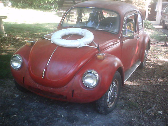

Hey SC . . . What's with the life preserver strapped to the hood of Stupie?  Planning on seeing if it will float or something?   8)

Zen,   Yep, thats a life saver on the hood. I was driving to work and  a neighbor had that perfectly good life saver laying on a can next to the road.  I love it when I don't even have to open my car door to take other folks trash.  Since my swimming pool turned into  a malarial infested swamp and the city orded me to dispose of it.  I had no use for a life saver.   But Wait!,  What about a Hood Ornament.   Crickey, Genius.

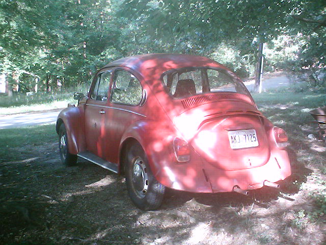

Opps wrong Pic.  that one is Stupies new to me running boards and the rear bumper removed.  pretty sporty Huh?.  Stupie has a nice can!
Here is the Hasslehaff  Bay Watch Stupie
