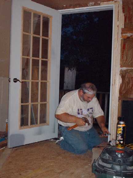

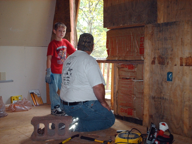

Well since you asked . . . I started what I thought would be about a 2 or 3 hour job this morning about 10 o'clock.  I removed a window in one of my upstairs bedrooms at my cabin and replaced it with a door.  I left about 10 hours later.  The door is in, but the job isn't finished.  I've still got about 2 or 3 hours of work to finish up the wall inside.  The good news is, now I can get on my balcony without having to climb out a window.   :lol:
Notice how bright and sunny it is outside just after I started the project.  This isn't a typical stud wall.  It's all rough cut lumber with the framing running right to left, not up and down.  I had an electric wire under the window to deal with as well.
Notice how dark it is and I'm still not finished!  It was a LOOOOOONNNNNGGGG HOT day!
