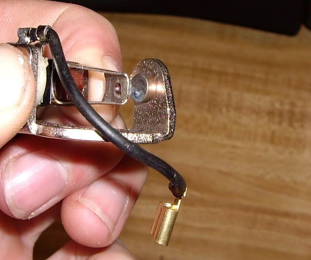

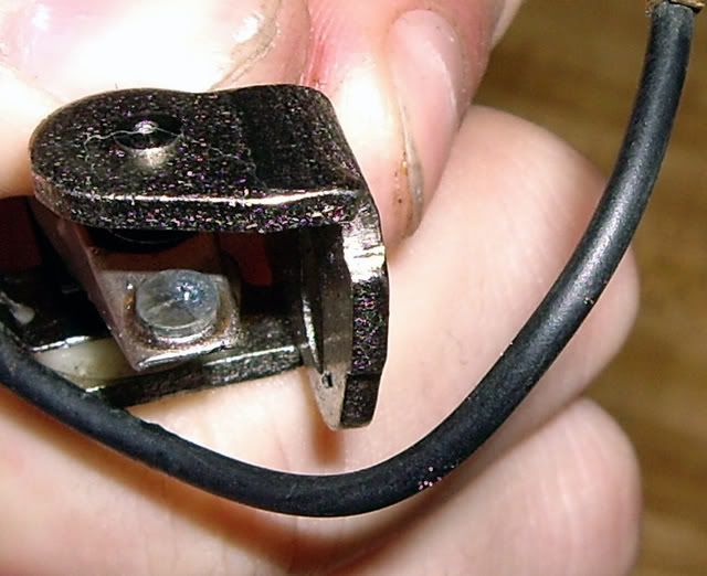

alright i found time to do a little work on the van. first thing i tried to do is check, and adjust the points on the dist. well... i found this.
looks like i need to replace that... a nipple on one side, and a hole in the other.
moved on to the valves, no problems there, they were all close, but i made some small adjustments since i was there. seemed like there was a bit to much oil in the 1,and 2 cylinder head side, probly need a valve, job soon.
i figure i best order some new points, and might aswell pick up some new spark plugs.
head tempature?
« Reply #24 on: January 06, 2008, 04:37:08 PM »
Bosch points/ cond.  W-8 Bosch plugs ONLY.   Joe ,there in Cleveland should be able to take of that for you. Don't forget to put some lube on the rubbing block of the points.
